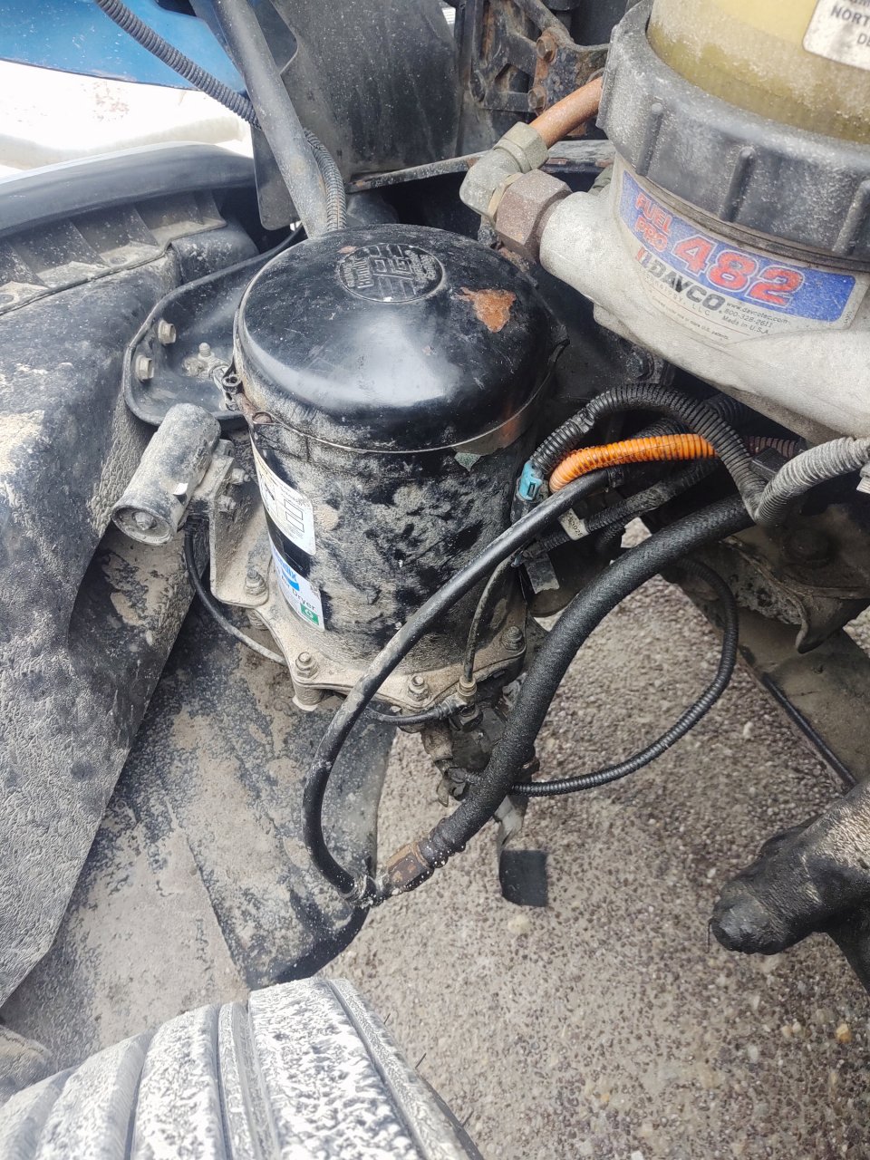

    Well the air dryer went and the compressor seems louder, but it still works. I got a new AD9 , air dryer for 340 plus another 20 for a governor. I took off the old one today. I'll put the new one on tommorow. Im not sure what to do with the compressor. It hit a180 psi , then I killed the truck and made a tank leak to keep it around 105 and 135 psi for the two tanks. But it didn't cycle off for three hours.

    The old,"The air dryer isn't working......"

    Air dryer? Air dryer????? We don't need no stinking air dryers.
    The governor would have help.
