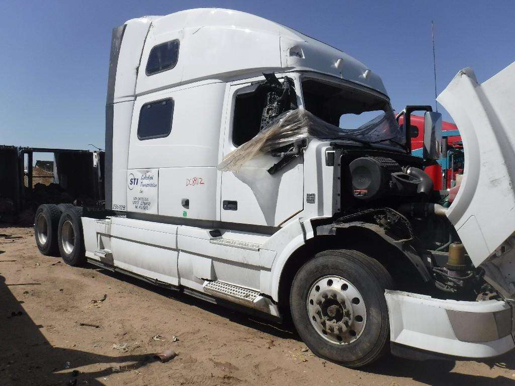

    OMG.
    It's another white Volvo.
    The first one was obviously a scout. Now the rrst of the hive is going to show up.
