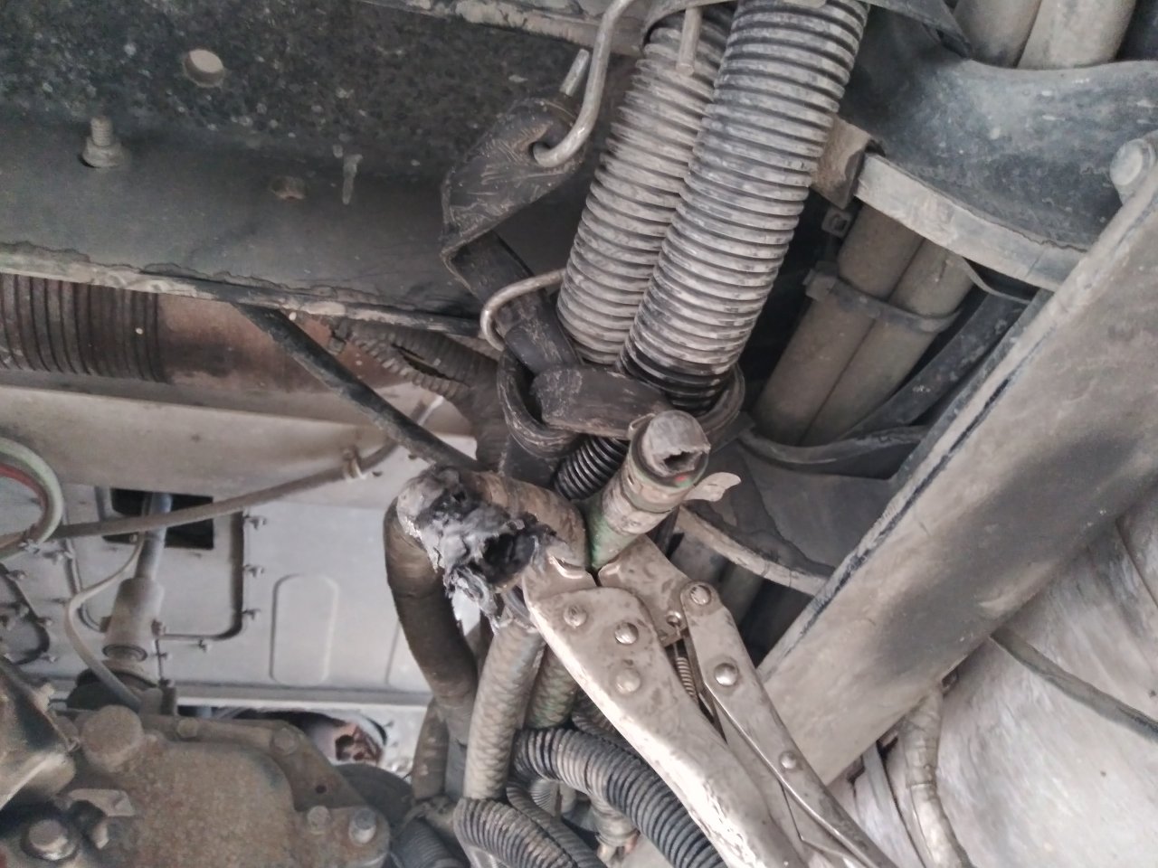

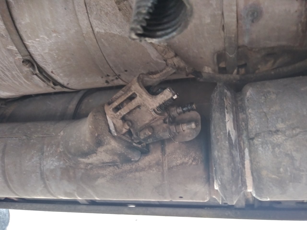

    Your truck DEF system butchered badly. Someone stupid didn't know how to disconnect quick connectors and cut them off. Now whole lines need to be replaced to keep DEF injector cooling system working. If you bypass injector will be clogged with dry DEF what will put your engine in derate mode and red stop engine light is highly possible. If you have no other options only to use clamps follow the recommended cooling system fill up procedure.
    1. Fill radiator reservoir to the max mark.
    2. Run engine with radiator cap open on idle with short accelerations to push all air from engine until working temperature reached.
    3. Refill coolant reservoir if required and close radiator cap.
