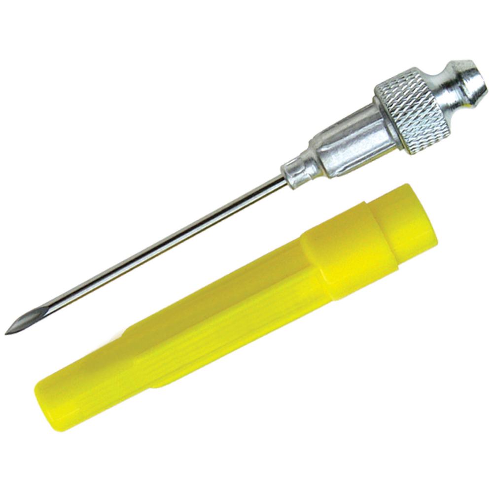

    Tho something many people are not aware of? (Grease guns) There is a wonderful adapter for sealed bearings known as a grease needle. You stick this on the one of the gun and puncture the rubber seal. This way the non greaseable bearings can be refilled. It is also good for packing bearings. Slip the needle between the rollers and pump away. No need of the wad of grease on your hand. Unless you like getting that filthy.

    You can build one really easy... Take an extra grease zerk and drill the ballbout of the tip with a bit just big enough to cover the ball. Then use what ever fitting needed to attach the zerk (tip, drilled out ball will become the nozzle) to the end of grease gun hose. Will squirt kinda like silly string.
  9. D.Tibbitt
    23,025
    159,434
    Great idea thank u
