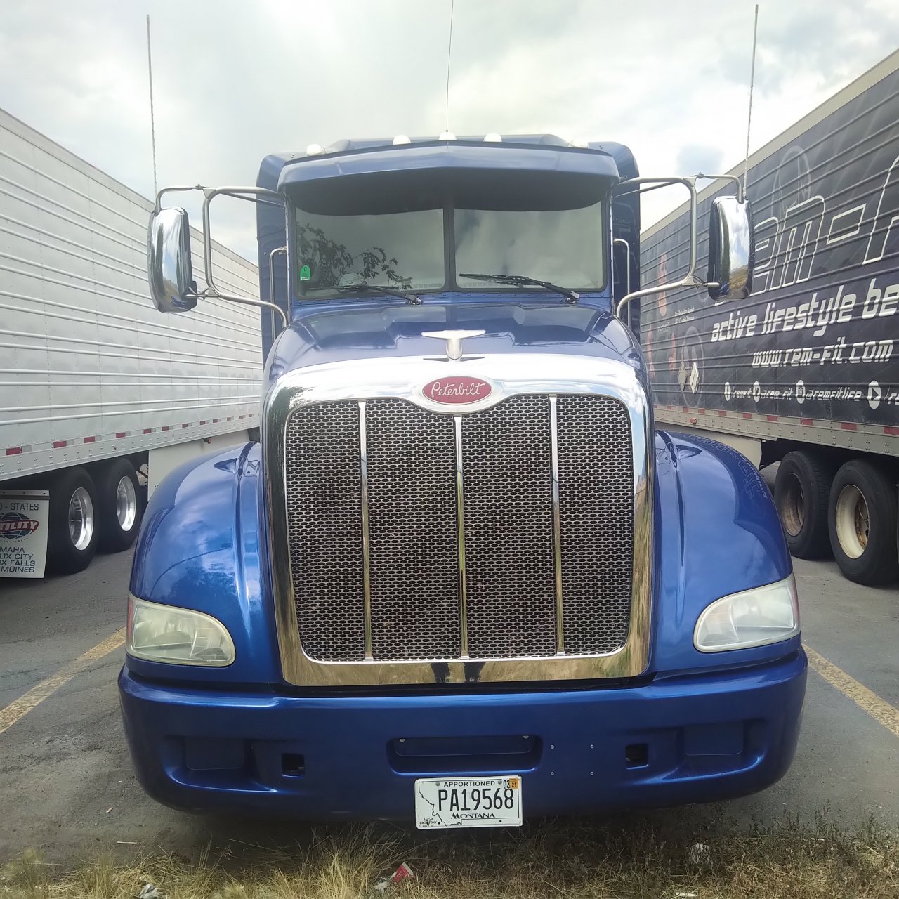

    Did you treat Big Blue to a spa treatment?

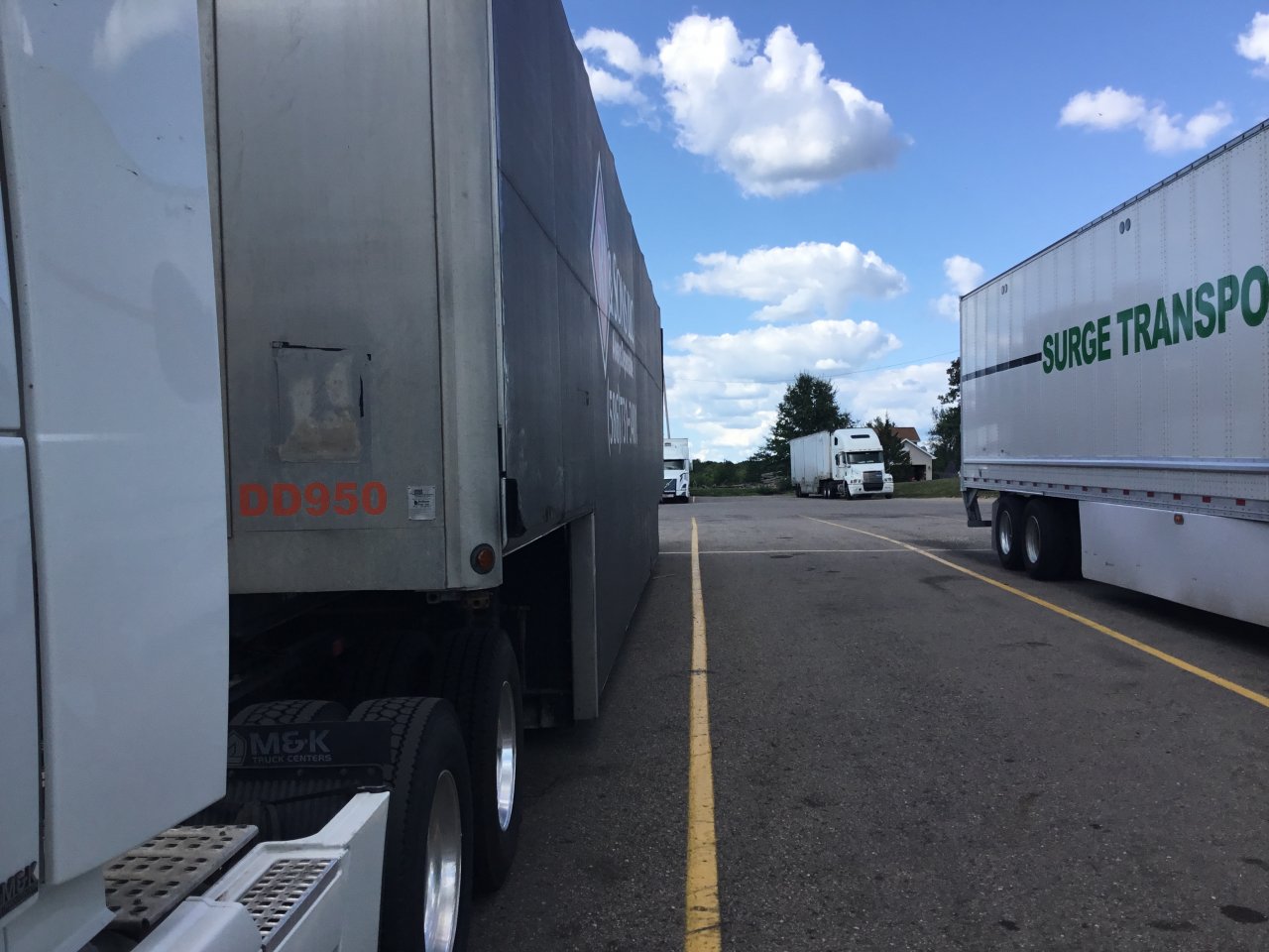

    You just start using a Conestoga?
