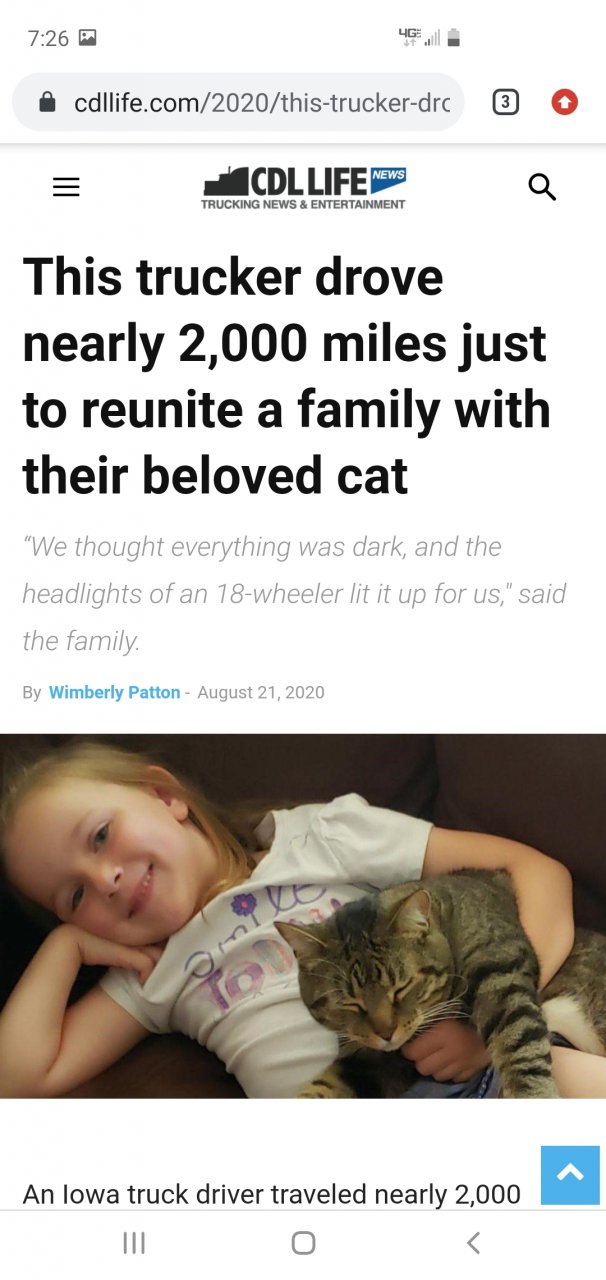

    Talk about going out of route....
    Dispatch: Um...driver, the load is going to the opposite end of the country. Why are you going towards Florida.
    Driver: I got a drop off this cat!
    Dispatch:

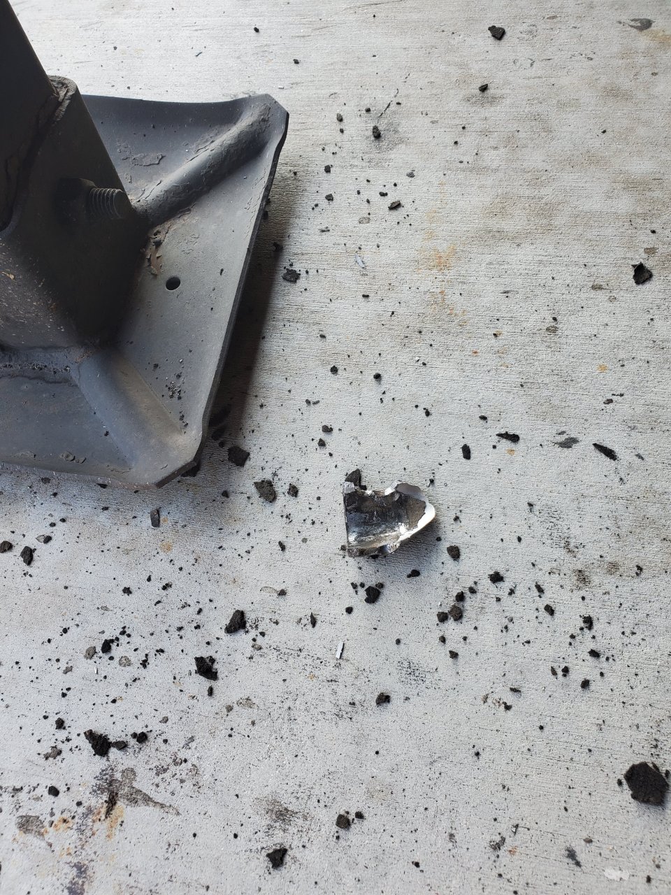

    Have had to rebuild several of those when i was in the fertilizer business... A piece of pipe, a drill with drill bit, 2 bolts with nuts and washers, and a couple wrenches... About a $25 dollar repair.
    Please let us know what the shop charges to fix that... I'm sure it will be something ridiculous like $300.
    Edit: in a pinch one can remove the landing gear crank from one side and move it to the other... Just have to operate each landing leg separately, but it will get you moving.

    I can't budge the bolt off the one side that's rotted / snapped off.
    I thought about what you just described.
    It's fully loaded and they had it cranked up so high, I can't get any weight off it.
    And now the one side is lower, so it's afu, as is my back from F with it.

    Drop air bags on truck, 4 by four on fifth wheel air bags up. Weight off landing gear.

    I thought Landstar didn’t let the trailer fleet get that old.
