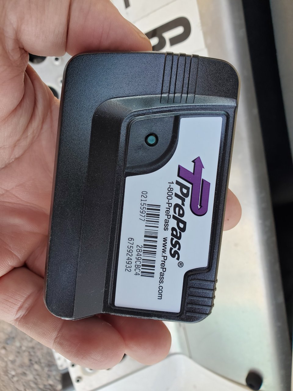

    you know, those things have been out for a while, right?

    Yes. But you must understand how traumatic of an event it would be for the people at Landstar to send it to you ( like they used to ) at the same time they send you everything else.
    This extra step creates jobs and helps to stimulate the economy.

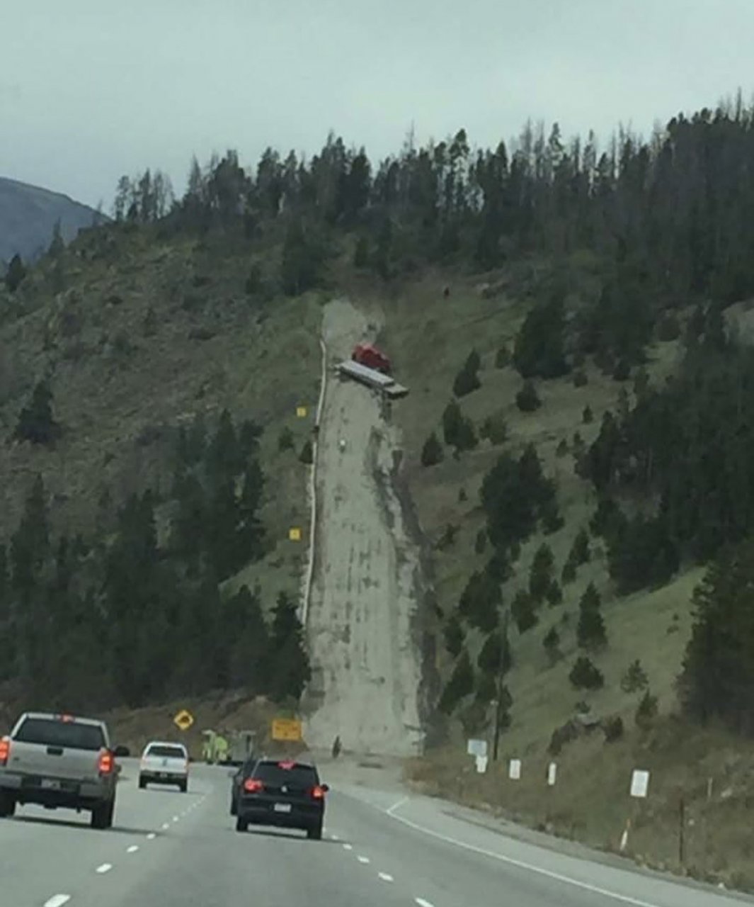

    I hope he tarped the load he left in his pants after that run!!!
