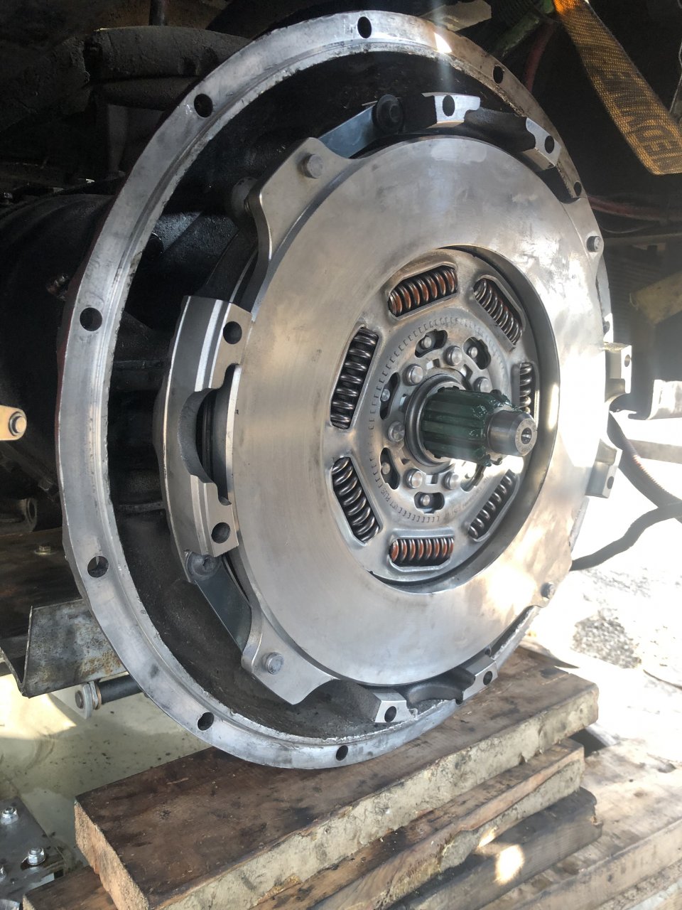

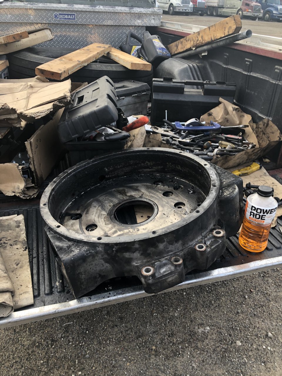

    7120EC57-8D17-43AE-86BE-0AC6A77E6E3B.jpeg B512BAD5-1241-49A6-9979-4F3BB7B768A8.jpeg 1A94D364-6A59-43D0-97E4-6BCBD3F2DBCE.png Here’s the rear engine cover, it doubles as the inner bell housing, also motor mounts. Oil pan has to come off, and engine supported. Or held with a hoist from the top. After it’s installed, Install new rear main, flywheel, clutch, trans. I hung the clutch on the trans, stabbed it, and tightened bolts through the acess plate, while barring engine over. Much easier that way. New Eaton 2000lb easy pedal, comes with pressure plate/ clutch all in one piece. It’s heavy, but makes for a nice quiet clutch.
