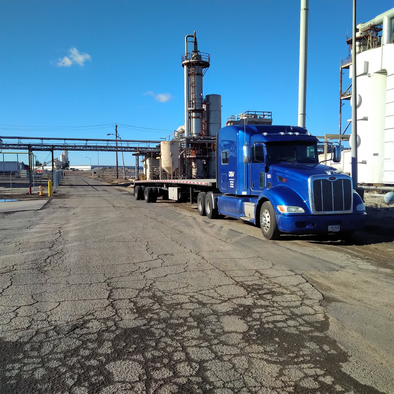

    Better height check that load Driver.
    Now get It Tarped up and down the road
    Over the Snowy mountains and through the woods to Recievers you will go.
