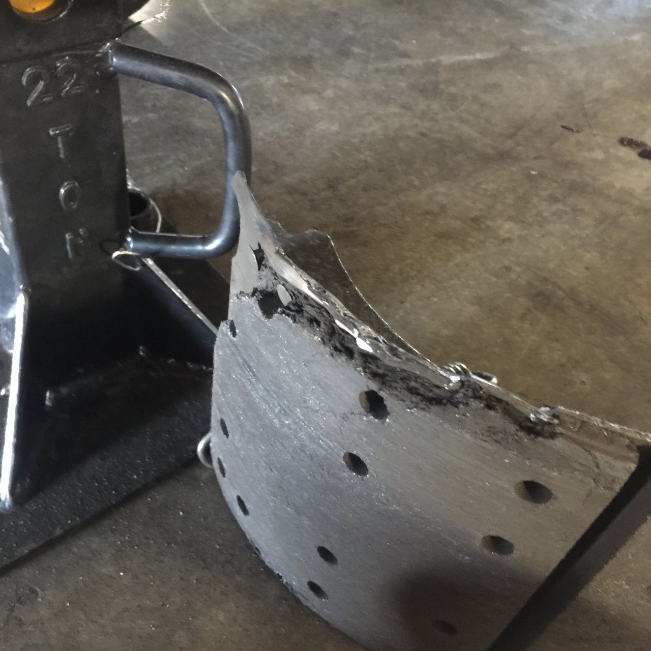

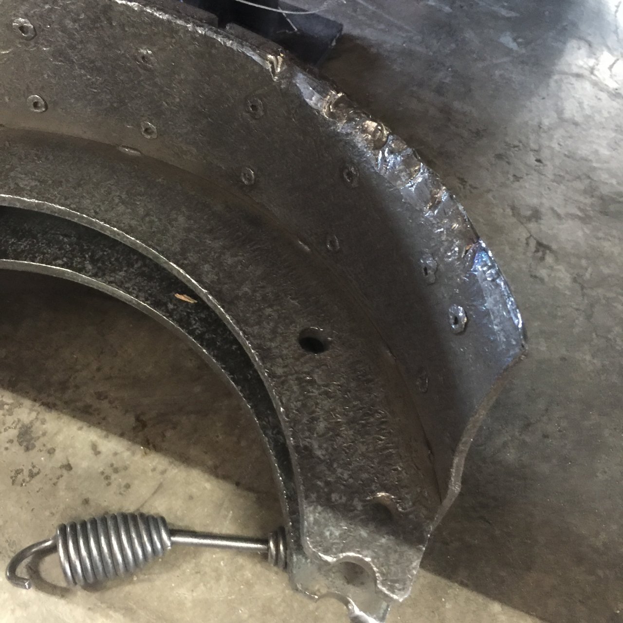

    Yup a drive.
    Left side isnt actuating at all...I’m not losing air my thought was brake chamber.
    The spring hanging there...no clue. I just know “not good” when I see it. LOL

    Left side looks broken around the hole the push rod goes through
  7. otterinthewater
    5,601
    29,370
    May 10, 2018
    Santa Barbara, Ca
    Interesting. I missed that. I’ll go check it.

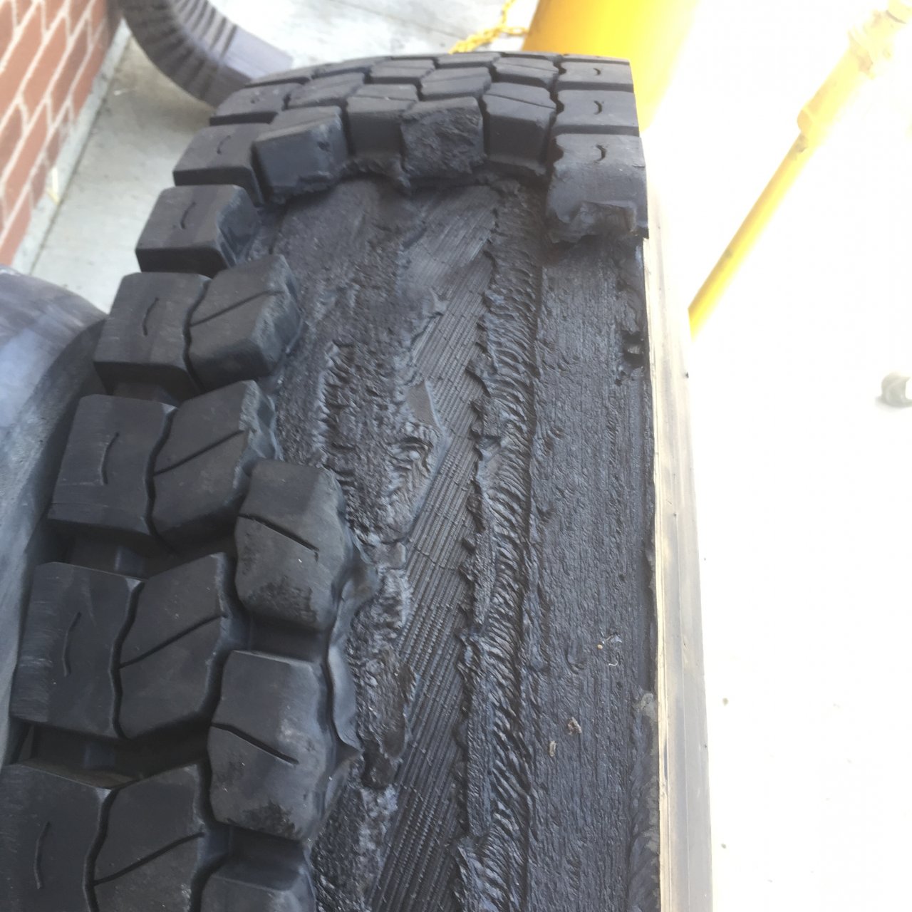

    It is why I dont like recaps. The glue isnt as good as the original manufacture. There was a time when using recaps on drives was frowned on. I guess times have changed. Locals here no longer run recaps and the tire shop sends them to the shredder.

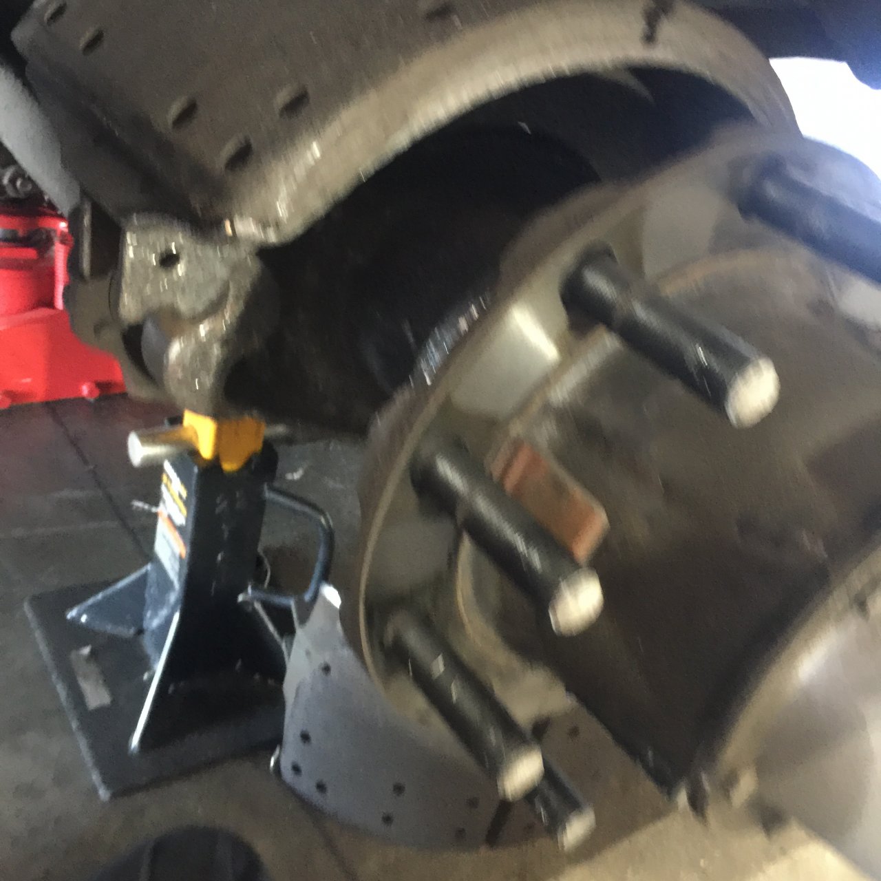

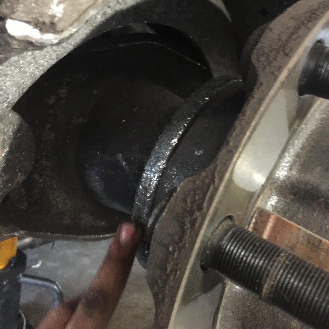

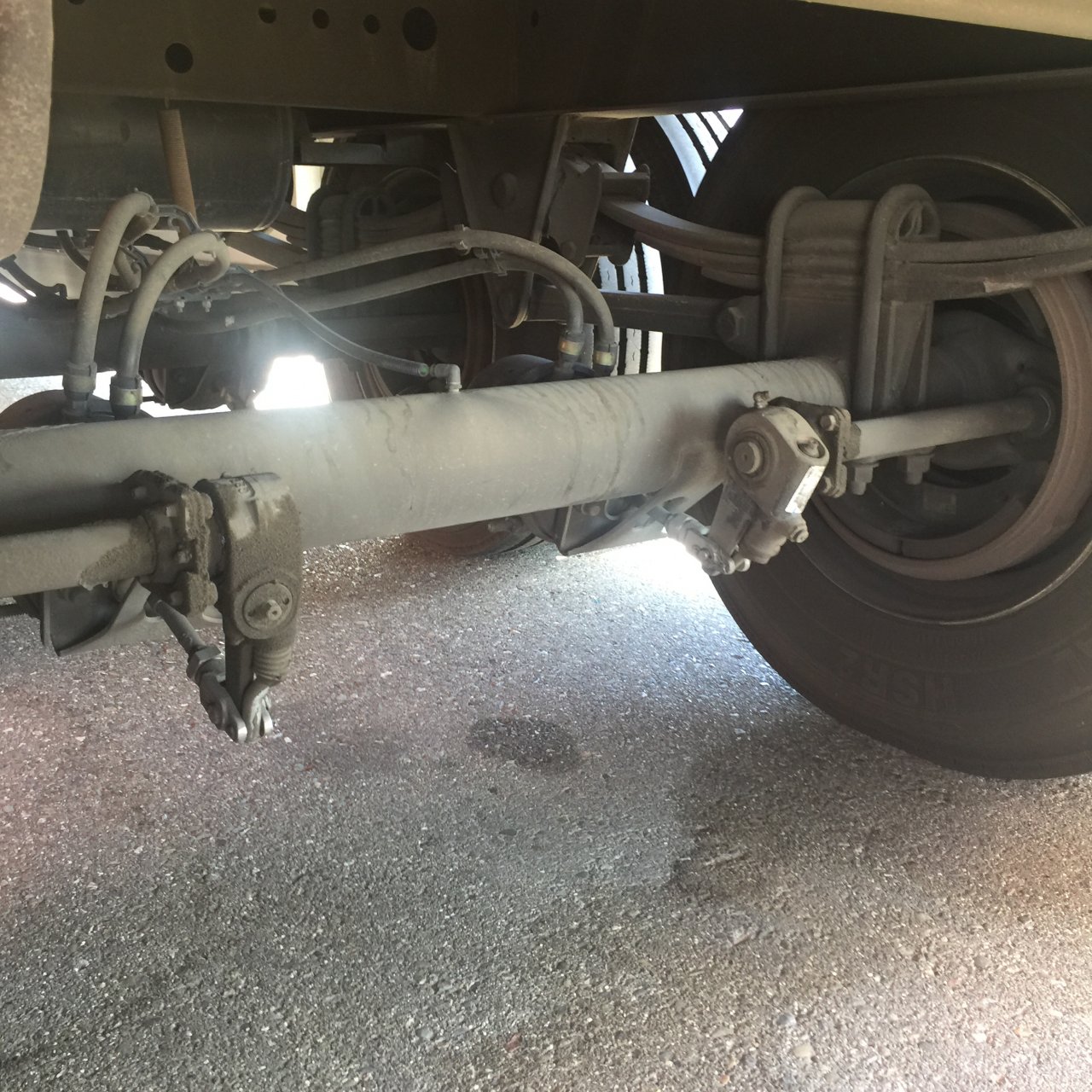

    Well two different slack adjusters. That’s a no-no. So they put 2 new ones on.
    Looks like everything got beat to ####. New hub because the tone ring is eff’d up and the list goes on...shoddy repair leads to more delays. This trailer was brand new in November of 2018. Sad what’s been done to it.

    Wow. Someone drove that a long time like that.

    Took me looking at that second set of pictures to realize that trailer is not air ride....
    No wonder they can't get good freight (and pay the drivers better). Most of it requires air ride even if it is heavy.
