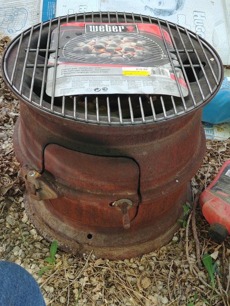

    Did you use a torch to cut the door?
  3. Cattleman84
    Cattleman84 Road Train Member
    10,057
    71,979
    Nov 1, 2017
    The Sticks, Idaho
    Handheld plasma cutter...
    Side note: the hinge is originally from a mid 90s model Freightliner... Ive trimmed off some excess metal that was nit needed in thus application.

    Heres a few more pics of it...

    Guessed plasma cutter, but did wonder how much "bottled steady"
    you took before you whacked those nicely rounded door edges?
    Old perfectionist here, and can tell but not do...
    You need a circular concrete "stepping stone" about 2" larger than
    the base rim to set it on. Gonna rust out on the ground.
    Added change for the 2022 model. Steal someone's all metal welding
    chipping hammer. Cut the hammer part off leaving about 1.5 inches
    on the coiled handle. Thread it and jam nut, flat washer, it on the door.
    Wife won't burn her hands when you send her out to add fuel then...

    Any welder can fab one up. Tho I would put a 3 inch chmney on the back with damper so a person could put a flat grill across the top. Then they could do things like eggs or pancakes.

    Well heck man. Lets go all out and weld some rebar legs to the bottom. Give it a false floor so it can hold the ashes for cleean out. We could wrap it with fiberfrax (space age insulation) and make it cool to the touch. Put a swing latch on the fire door for that wood that pops wont shoot sparks out the door. Put a griddle plat on a pivot so it can swing across the top with the use of a spatula.
    Oh and while we are at it we can get a tub nearby to hold water to wash the dirty pans.
    Keep at it we will get OSHA involved.
