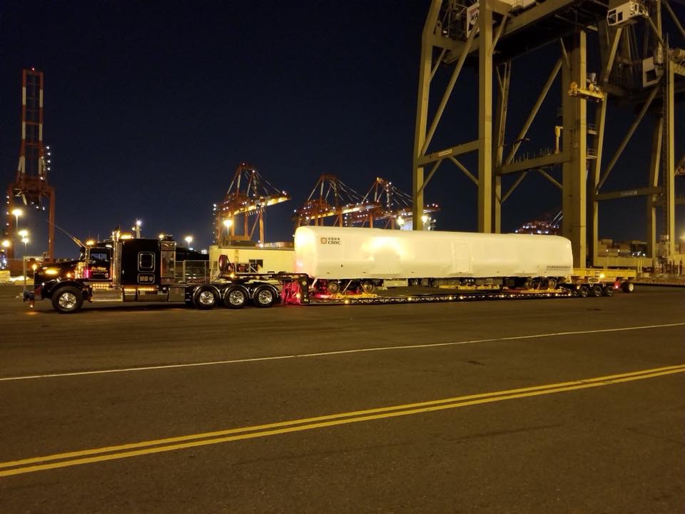

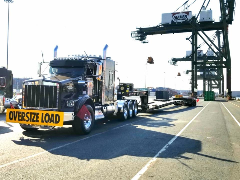

    Sure there are. Here’s an Xl stretch step multi axle.
    Here’s a stretch double drop with an insert behind the stretch section. 70’ in the well and around 100k payload. If i recall correctly. Pretty neat setup.
    2A07106D-3BE9-4740-AB2F-2A81BE1483EF.jpeg FBA30E62-C57D-4E72-8FFC-77CC644480C2.jpeg

    Those are not multi axles.
    “But Six...”
    I know what you’re going to say, but a 7 axle rig is common too. In certain areas, 6 axles are common, even 8s. That’s why, back in the day, 9 axles was where heavy haul started. A multi axle has a jeep or a stinger.
    Otherwise, anything bigger than a single screw pulling a pup is a multi axle.

    ####. I attached the wrong photo in the wrong spot. That’s a 2+3+2 stretch step.
    That’s what I get for being up three hours before the sun.

    Well, I stand corrected. I did not take into consideration beams and towers. Most of the really long heavy stuff, they don’t stretch, they either add in a deck insert or use a turntable and dolly.
