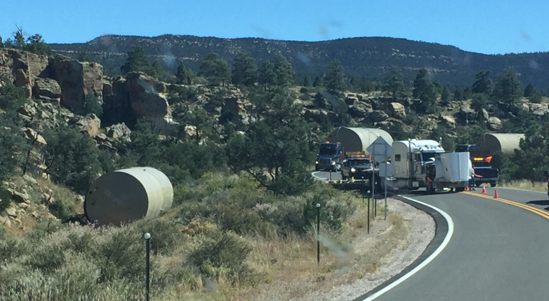

    I can’t answer your question directly. But maybe I can answer it indirectly.
    I pull a lot of paper roll stock. Our securement works pretty much the same. Our load, like yours, is really too heavy to move on it’s own. If it did, it’s going to do some damage.
    It’s basically securement to prevent movement under excessive G forces. It’s never really going to prevent the load from moving under all circumstances.
    This picture - Guy had proper securement on load. The G forces he experienced were simply too high.

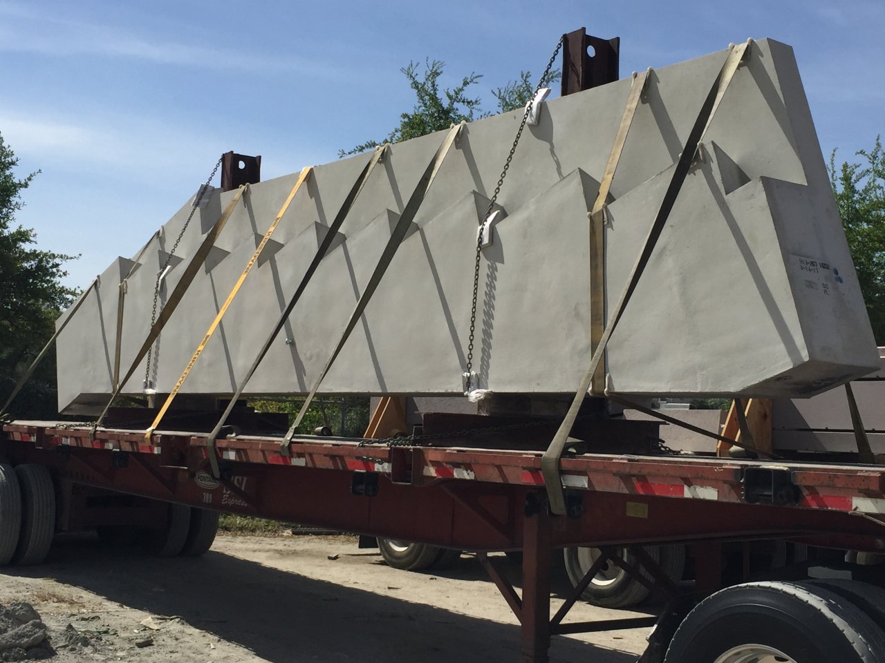

  11. Diesel Dave
    9,751
    33,488
    Jan 20, 2010
    Hesperia, Ca.
    5D1EB1ED-DF92-4462-AB12-66F63141F8BA.jpeg Over securement with a peace of mind
