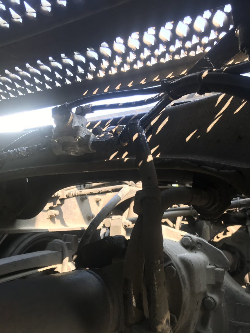

    Found it..... I pinched them off 1 at a time and still leaking. So I started randomly pinching lines and it stopped when I pinched a line under the catwalk above the front axle!!!!! @AModelCat thank you.

    What is that line connected to? I wouldn't try and drive with it pinched off. Could be something important.

    No I changed the part. I’ll take a picture of it after I get cleaned up..... loves had the valve in stock.

    Pinch the emergency lines right at the brake chamber. You have a bad brake chamber.
    And when one goes, it's best to change them all.
