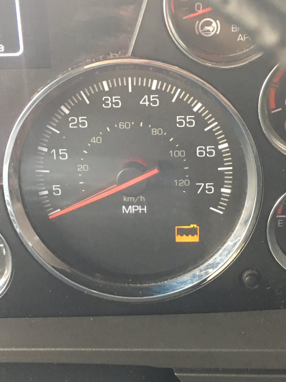

    You should be able to tilt that grill forward. Look for the cotter pins.
    Coolant as much as half low in reservoir.

    coolant,had a w900 and that light come on sure enough I had a leak.

    I did not read all the replies. You got either a problem with low coolant or a bad sensor. Several years before I retired I had that warning and it kept getting worse. Would check the fluid level and it was above the sensor. Still I had that light. Finally a mechanic replaced the sensor and I got no more warning light.

    Nothing seeing any leakage

    The third shop finally went ahead and dug into the sensor. It was rusted. Don't ask me how something like that can go bad. Must be a inferior metal o something.

    If they changed a water pump or otherwise drained some coolant, the truck will typically need to have a secondary top off after driving around at normal operating temp for a while. Takes a bit to get the system to come to its natural level in the expansion tank, then it should be topped off WHILE COLD to the cold level.

    Yea they just put a new water pump in. I turned my truck on and it didn’t come on anymore does that mean it’s back to it’s normal function? It’s still below the min mark so I’m gonna get it filled up in the morning. I’m at the terminal so
