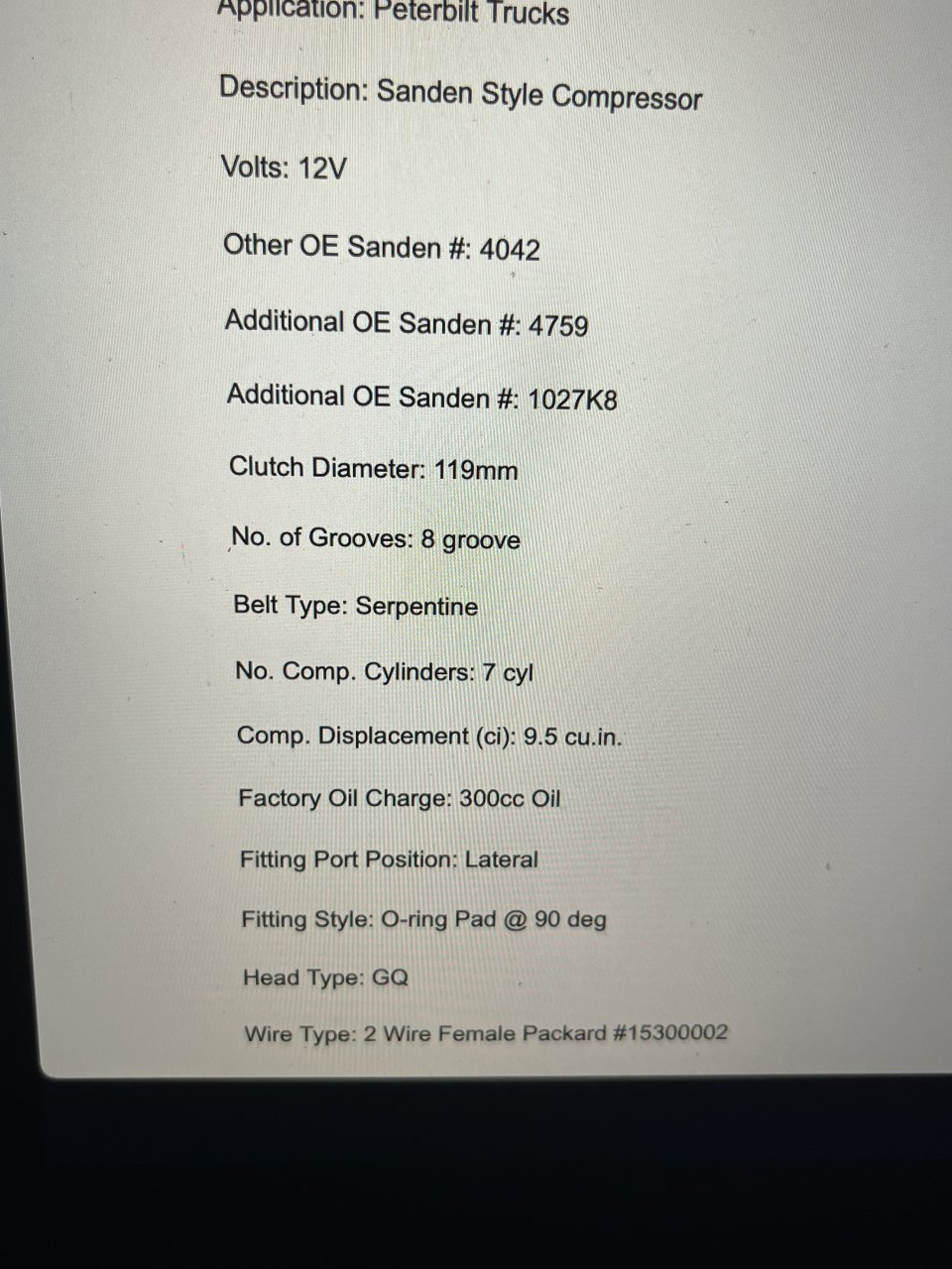

    This is from the site that @skallgrime sent me B4BA9256-E16E-4957-B30F-74375DF7F065.jpeg

    Ill have to look in the morning....but the picture I took above the part number is 03-1404s. which is listed on the picture you sent. I also found the 03-0609s on that site also

    I took a picture earlier....it says GQ on it.
    Edit to add....
    The 03-0609s the lines go into the back of the head. I need them on top

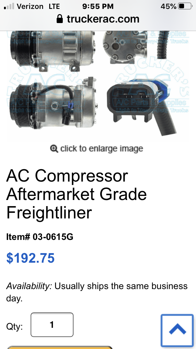

    A7EF182B-73C8-47C0-9B2E-33E2246D25F9.png My guess would be this one. But definitely double check. Get the letters from the head. Looks like they all have the clutch fused now. I’d ask about that. They all say diode protected, only the last one says diode and fused. Fused clutch will save some grief if compressor ever locks up.

    It looks like the 03-1404s is the one.

    Im not sure if it makes a difference but the one you sent above doesn't have the GQ on the back one the head.
    The 03-1404s does have GQ on the back of the head.
