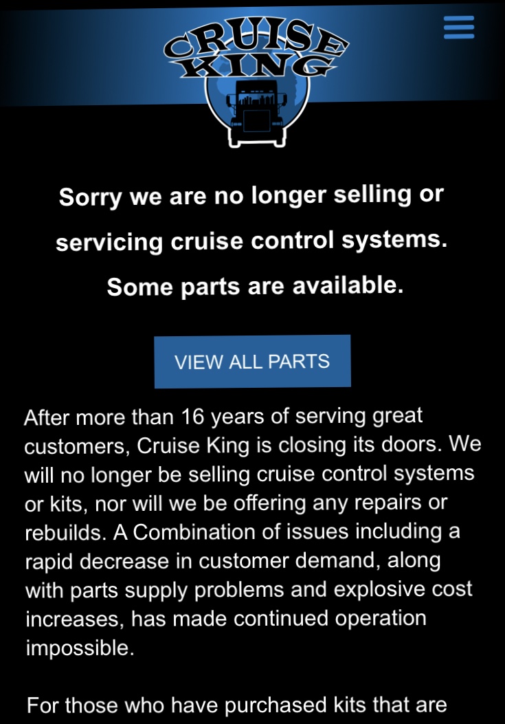

    thats kinda where im at! if i knew the kit would work from summit id get it, i dont mind makin up brackets to mount or wiring , just not sure if it would hold up

    Call king cruise. I have installed a few. I dont see why the generic kit would not work.

    I just did a little looking around and looks like alot of the aftermarket cruise setups are electronic and use speedo sending unit signal for reference. Also no vacuum servo. Electronic. Much cheaper than Cruise King but no way as durable I doubt. The last owner must have had the company 16 years because I bought my last Cruise King in about 98 and know it was available as far back as at least 93 or 94.
    Great loss to us that choose to live in the past with these old mechanical dinosaurs.
