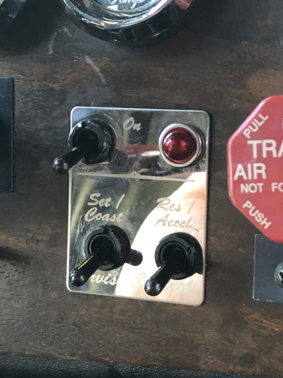

    How did the Detroit visit go? Glad I could help. I have been researching switch options and I think I will buy new Cole Hersey toggles (same as KW) and try to buy some oe style plugs to wire them. Buy 2 new lighted icons to go above them and install in dash with Rockwood or similar shiney stuff. As for the idle thing my cruise king control was a little rectangular box about 1x1x4 and had on off toggle resume coast button and a knob controlled rheostat that you adjusted speed with. In N you could press button then turn knob for desired idle.

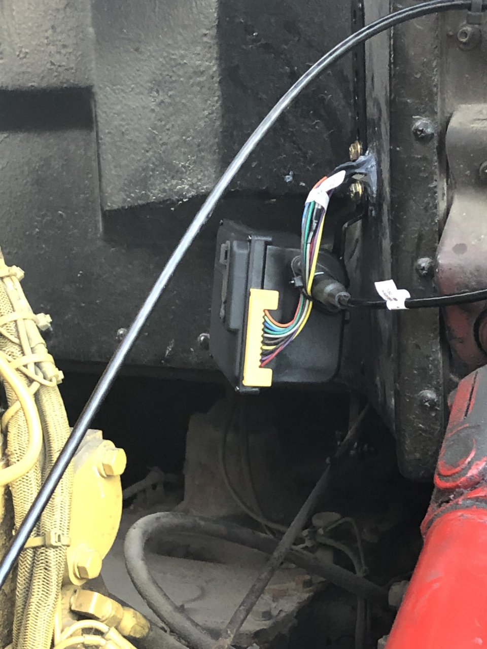

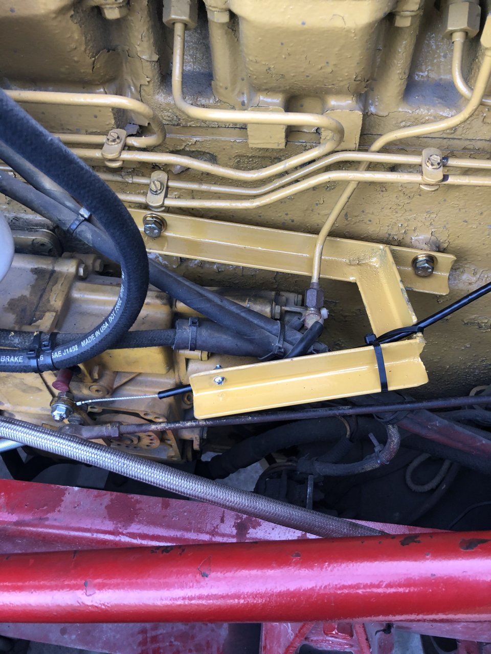

    kit installed,didn't use the switches it came with, got factory pete switches n plate, bracket i made is little overkill to hold a little cabe but seems to work
