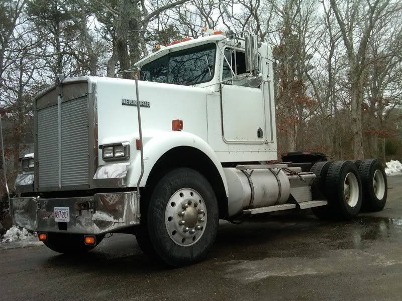

    Well that makes me happier. This is my first truck so I'm trying to feel things out still. My family owns a seasonal business that I cant just up and leave to drive for someone else so I'm going to do as much side work as I can with out it affecting my job here. I really appreciate all your info on here.
    Heres The truck all I have done so far is eraser wheel the person I got it from lettering off it.

    The axel wieghts on your tractor will be fine. I ran dump trailer hauling sand from Ct to RI for 3 years with 12f and 40's with a tandem 34ft dump trailer grossing close to 100,000 every load and never had an issue with the axels. RI i was permited for 102,000. I would go with a tri axel trailer before i swapped the rears in the truck. Nice to have the extra set of brakes.

    Ya an extra axles worth of breaks will more than double the life of your other breaks. If your third axle is liftable the tires will last several years on that axle. It will also ride better.
