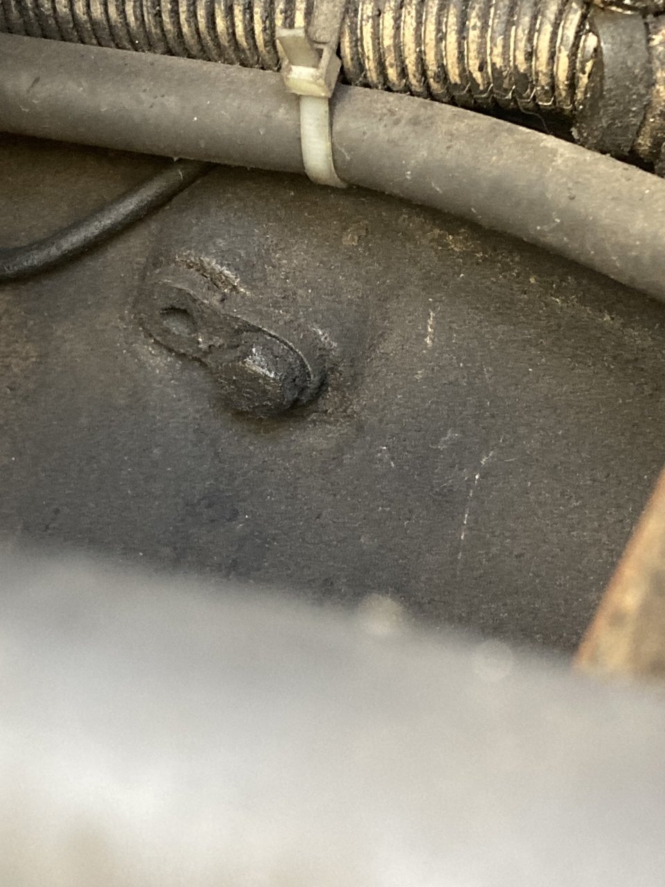

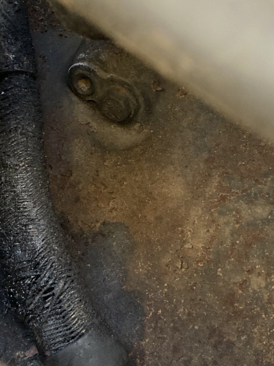

  4. abyliks
    abyliks Road Train Member
    4,241
    10,111
    May 2, 2010
    ludlow MA
    Front of the motor, should be a lever, usually removed the cable to avoid any…. Issues, with drivers, but leave the lever so someone can still get it started with a second person

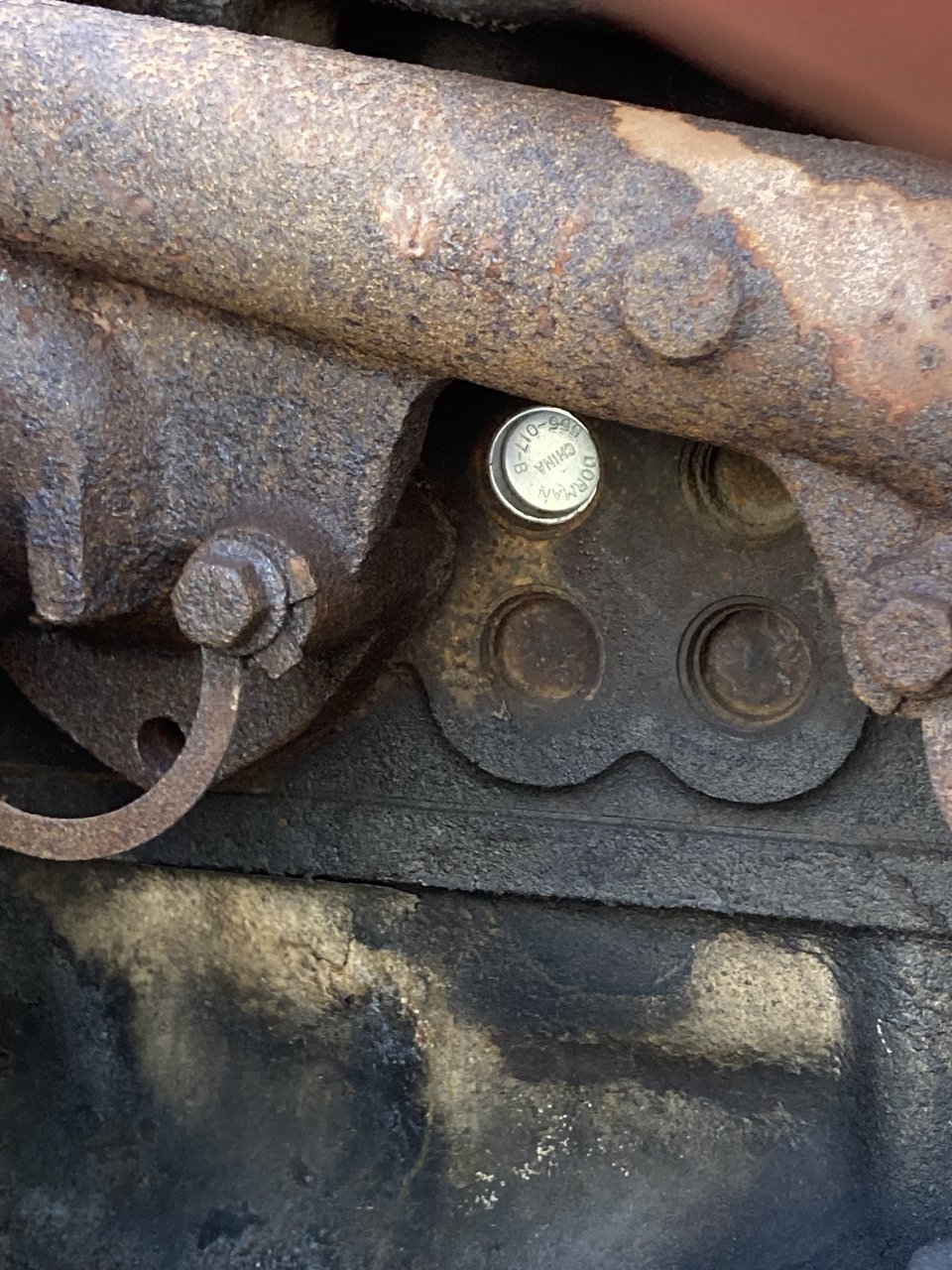

  8. Tbag3
    Tbag3 Light Load Member
    90
    30
    Jul 5, 2025
    What is the deal with the new plug, does that indicate anything. The other one to the left is the same way with one new shiny plug in the same location

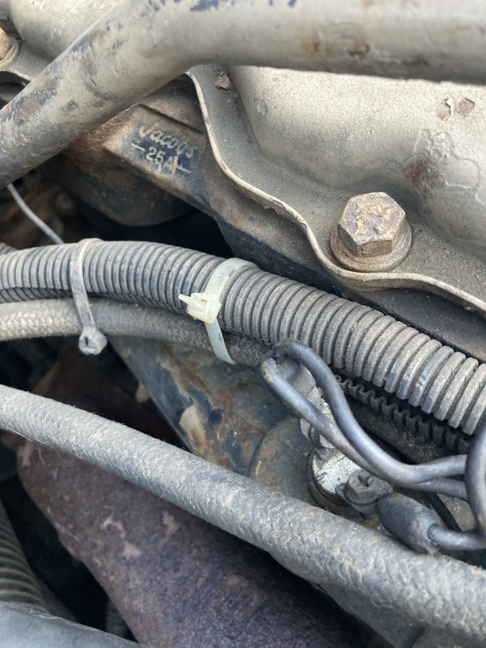

  11. SmallPackage
    5,920
    19,012
    Dec 20, 2019
    Marion Texas
    I wouldn't worry about the plug. Original one most likely corroded and went to leaking. I have a few heads that have had threads cut into a hole or two and been pipe plugged.
    You have original Model 25A Jakes. Those have become very rare over the years because a very small percent of engines had them back then. Newer Model 425 kits will work on them in most cases.
