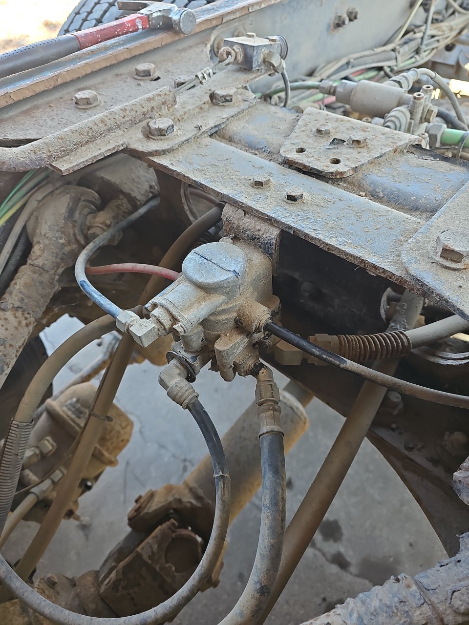

    Can anyone tell me what the name of this valve it on a freightliner Columbia 4 service brake line connected to it it leaking air on the bottom when I set on the brake I need to know the name

    I can’t think of the name of it right now, I have the box in my side box, I’ll check in the morning but, I bought mine from a dealer for 60 something dollars…

    Really $60 I replace one years ago on a different truck as I remember it was close to $200

    ABS valve. I think

    Air brake relay valve, I believe. Used to be a pancake inside. It takes applied air from the brake pedal and splits it to the individual brakes. The trailer has one too.

    What you have there is a Bendix SR-7 spring brake valve.
