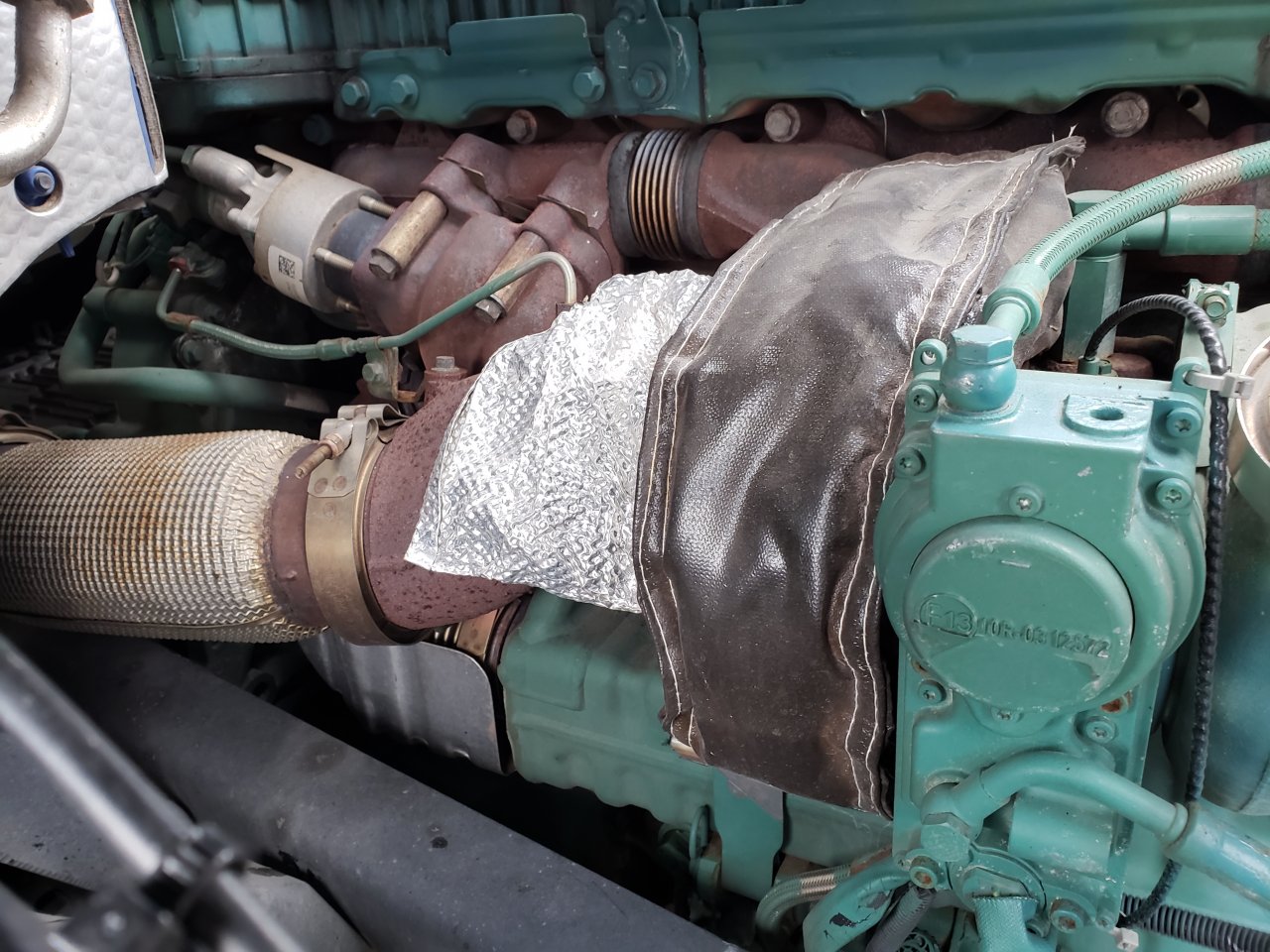

    @KB3MMX can you post a pic of the blanket and where to purchase one? Thanks!

    Yeah I'll try to grab a pic.
    Got mine in Amazon, T6 blanket, black.
    Super easy 2-3 minute install , uses two springs that go over hooks to hold it on the turbine housing.

    Do you need to take that turbo blanket off during summer?

    No. You want to keep as much heat in as you can for efficiency and health of the system.
    I'd like to heat blanket the manifold like a marine engine, Downpipe and whole DPF to keep the heat inside, everything clean and happy... Efficient.
    It's designed for this heat level with the factory fuel settings it won't overheat. It'll also keep the passenger side much cooler and reduce regen times.

    There ya go ^^
    That blanket also keeps heat away from that vgt module... Hopefully that helps extend the life of that thing
