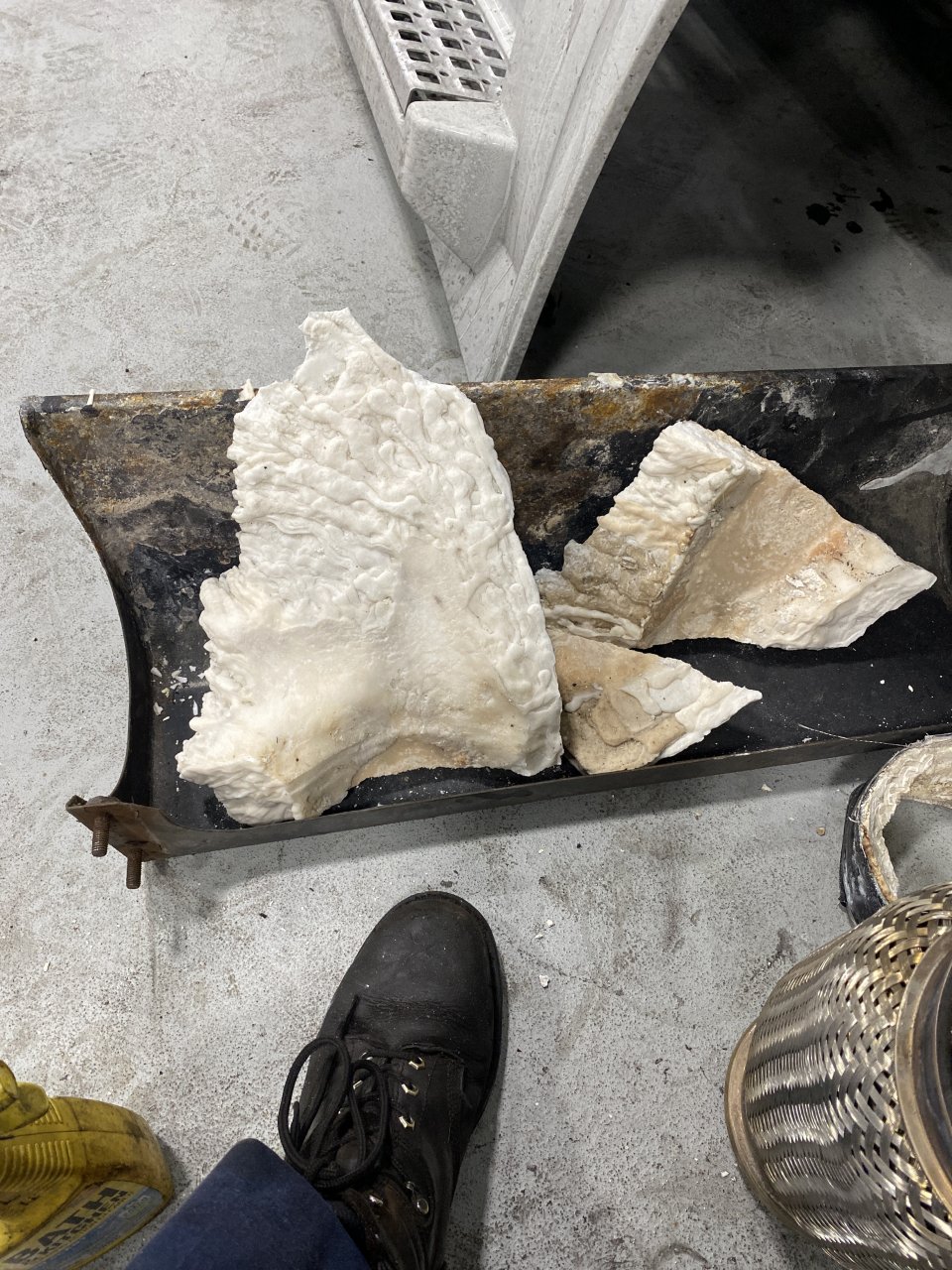

    Got any of that "DEF crust" left over?

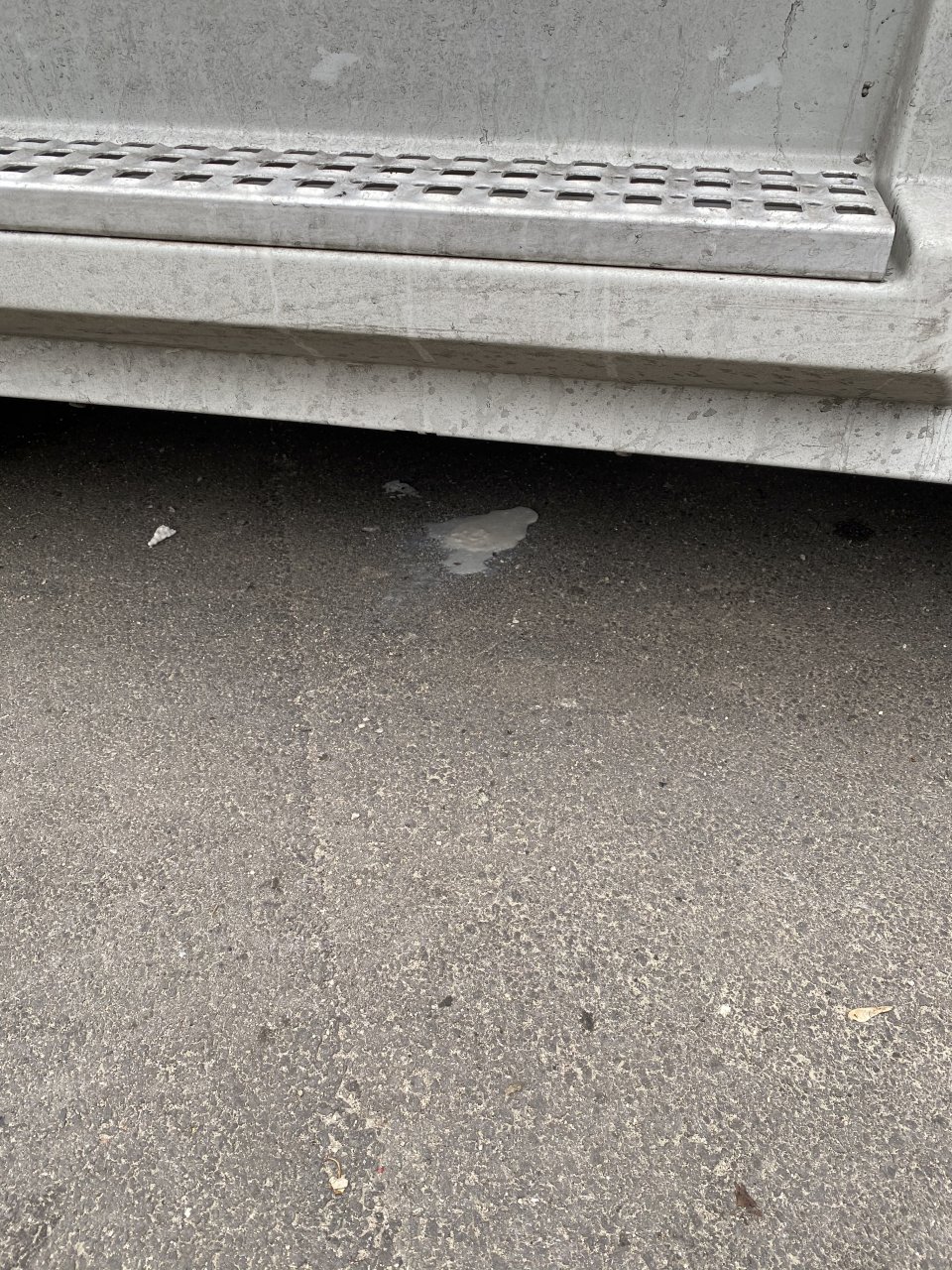

    This guy replaced def doser, bellows pipe with all the gaskets and clamps and still dripping def outside the system..

    Is that liquid def or is it the crystallization on the ground in the 2nd pic. The first pic shows alot of the crystallization which is usually caused by the system not running hot enough. How much idling is done. Try to reduce idling as much as possible mas newer trucks do not seem to have as much of a problem but older ones sure did. Might be a solution might not. Just my guess.

    Rob, thanks for the info. This just happened 2 weeks ago.. Volvo Dealer replaced Def Doser unit, fuel injector valve, bellow pipe with new gaskets clamps.. And still same.. On the picture I performed Regen- Crystal Sublimation and after 20 min started to dropping def

    Holy jeeze!! I have noticed in some of the exhaust replacement vids ive seen this kind of build up of crystals in the bottom of the decomp re-actor.....if i saw that on the vehicles we build i'd say the doser return was plugged and its overflowing out of the dosing injector or the decomp was not hot enough for the injection rate......did they check flow rates wben they did all that work? Did the tech not have eyeballs the size of saucers when he saw that or did he just laugh and say thats nothing......?

    Take a look at the last part of the dpf stack, I call it bed pan (I am sure that there is more of a Volvo name for it), it's nothing more than a canister with temp and NOx sensor, def doser lives there as well , but the part where it connects to the "reaction/decomposition pipe" , just before the clamp and after the factory weld, it tends to crack, letting all that white stuff out.
    Easy fix with a welder, I had it done not to long ago, but one spot was missed, contemplating using jb weld high heat for temp fix...
