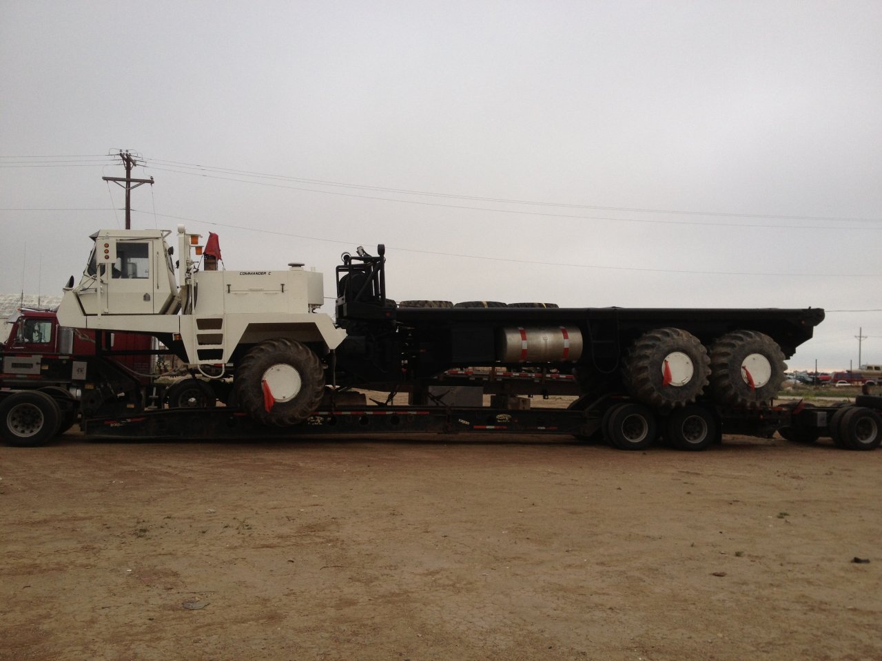

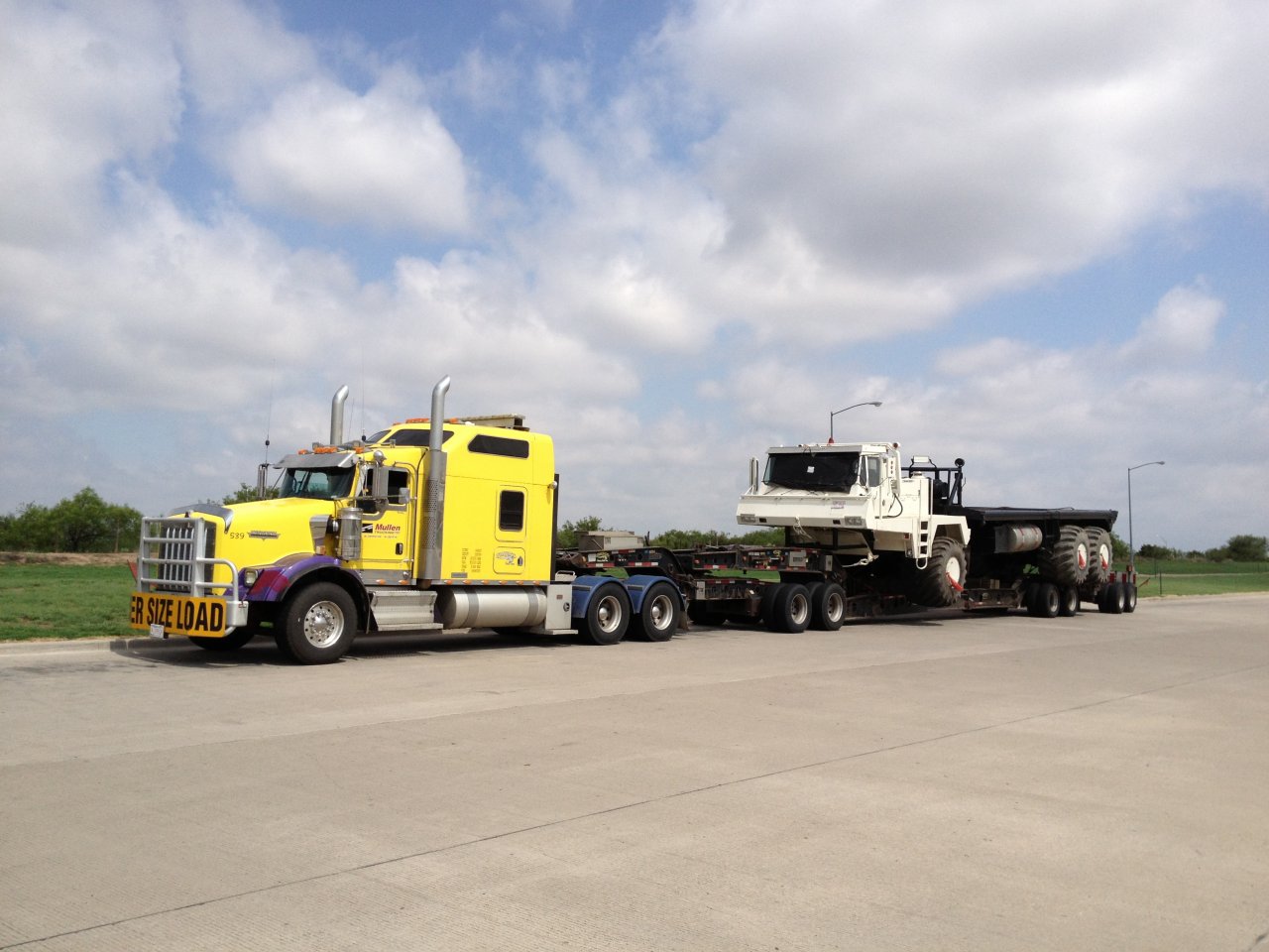

    Go ask in the Oilfield Section.
    I'm sure there's guys there that have run bed or winch trucks.
    I work with/around them a lot, and I know what they run. But I ain't qualified to give reasons for the answer, so I won't.
    95C4AF19-5CEE-4A2F-B677-BC9017FF4AF2.jpeg 7DEA4571-C6C1-43CC-84FC-458024CA934D.jpeg
    I've seen this truck before (the one being hauled) with Uber many lbs of weight sucked on the back with the front wheels four feet off the ground plowing through the muskeg, I'm thinking these guys will know what you're looking for
