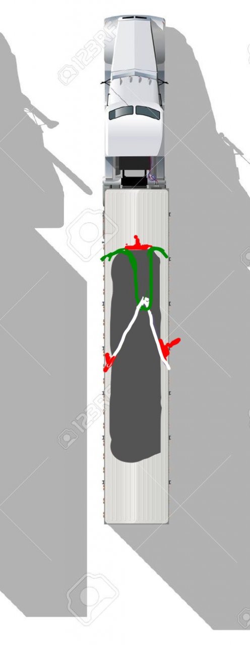

    You can cross chain the front of shotgun and suicide slinkys with 2 chains and 3 binders. I'll try to find or edit that pic tonight if nobody shows you by then

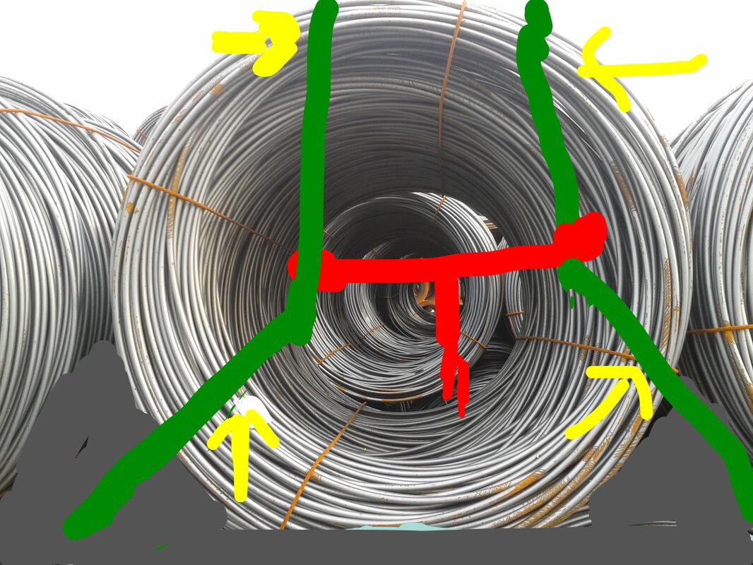

    This is how I do a safety chain on slinkys, steel plate, stone, tanks etc. you can also do the same thing with another set of chains on the rear of load.
    First thing, take 1 green chain, attach each hook to trailer so that the hooks are slightly to the rear of the front of load. Hooking here creates 4pts of contact when the chain is tightened (yellow arrows).
    After attaching green chain, climb up on deck and stretch it out across the load so that it forms a "v" and lay it on the load.
    Get 2nd chain (white one) and pass 1/2 of it thru the first chain to create an "X"
    Attach each hook of the 2nd chain to trailer at equal locations, then attach opened binders to both sides of white chain.
    Go back up front and adjust green chain and hook an open binder to the front.
    Go to the sides and tighten both binders on white chain and last tighten the one across the front.
    It sounds like a lot of steps but it takes less than 10 mins once you get the hang of it.

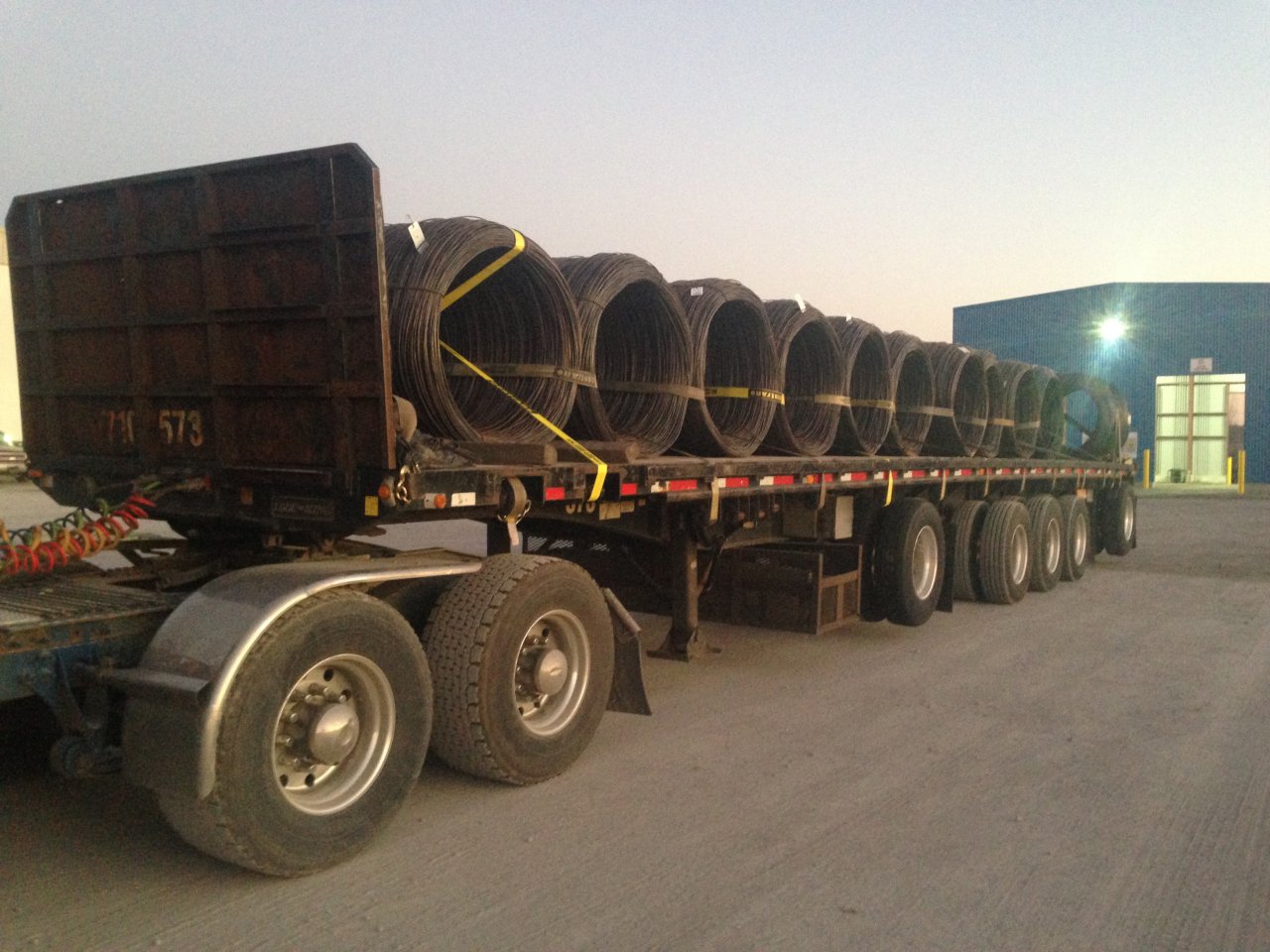

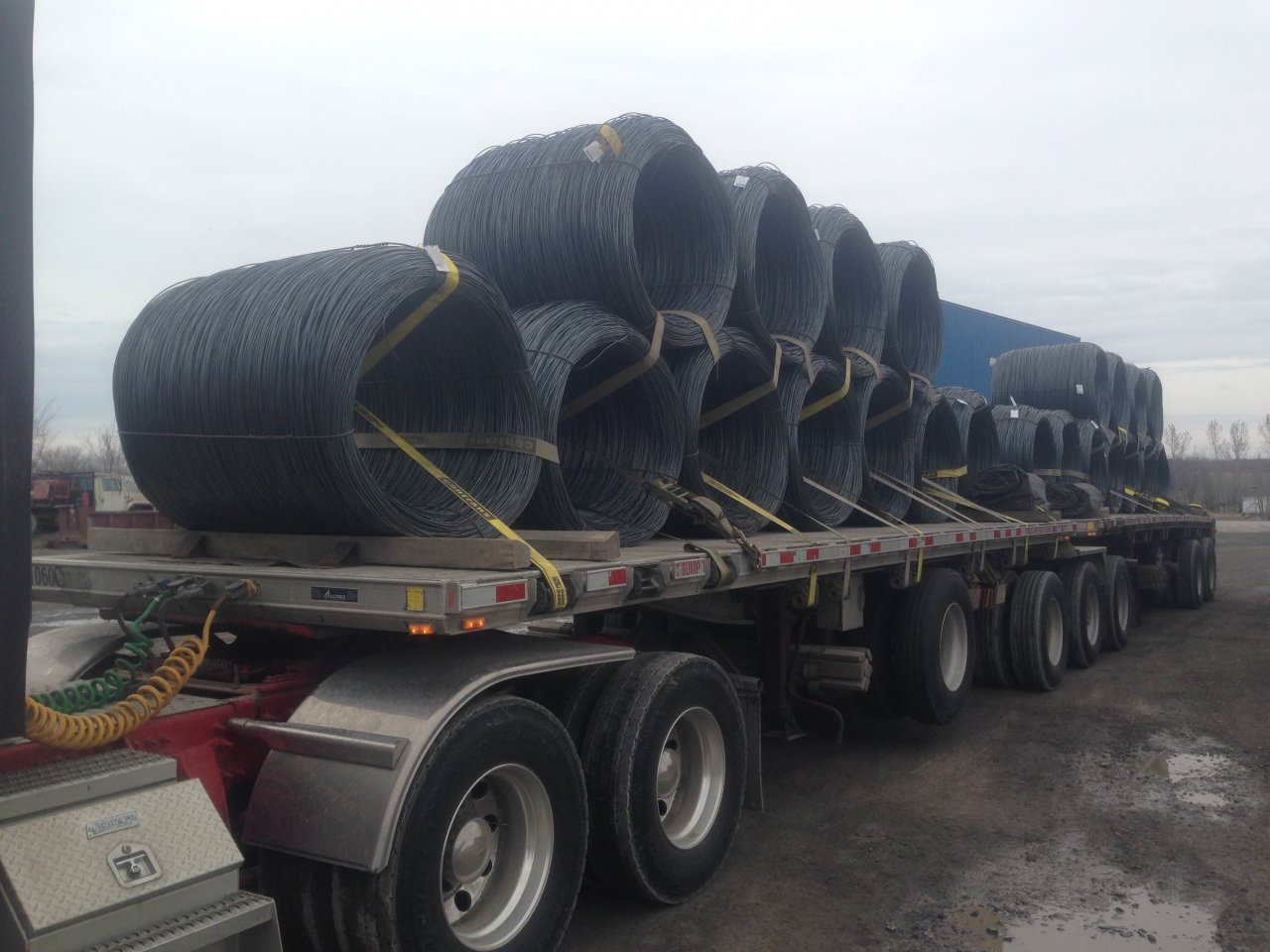

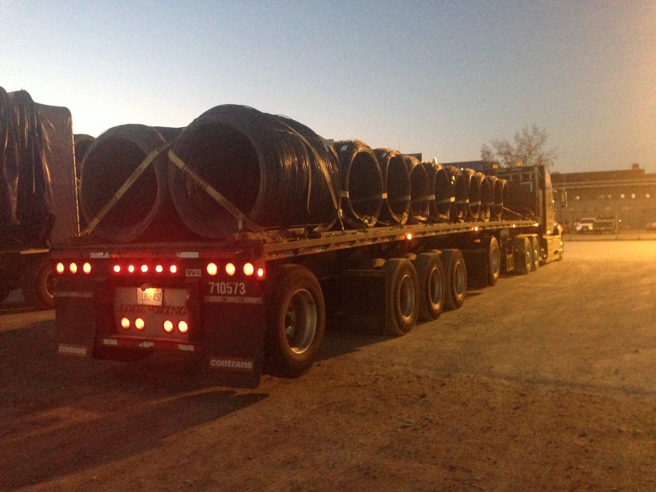

    I think my dispatcher is reading the forum. Go figure I'd get my second ever load of slinkies today after posting this thread. Pictures tomorrow.
