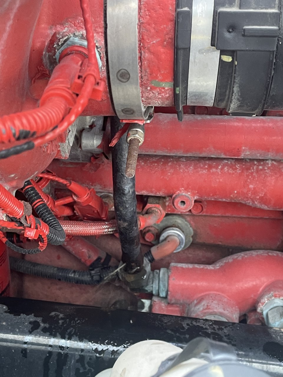

    Coolant leak. Shop is 23 miles away. Fill it and drive there? Or pay for a tow?

    Do you have a clamp to throw on that to slow the leak?
    If so toss one on, but even without I'd drive it the 23 miles if you have enough coolant to keep levels up.

    Tape it and go...I would.
    20 miles tow, they can screw you $1000.

    Tried duct taping it and seemed to make it worse. It’s rusted out and chunks are falling off it. Got an idea. I’m going to see if they can send a mobile tech out.
    Was going to top it off and run down there but I’m nervous I’ll go dry and seize up my motor. Then I’d have to declare bankruptcy and walk away from the truck on my second load as an owner op.

    Yeah, definitely do not want to seize it up.
    Mobile mechanic is a good plan then. Hard to tell in the picture how bad the leak is.
    Hope it is a quick repair.

    Looks a slow leak, but if the rust is falling apart. I guess wait for the mobile mechanic. I would probably drive it you do have low coolant warning that should shut engine off when coolant gets low. If you have couple gallons of coolant it only 23 minutes or 30 minutes drive. You could drive 5 miles check coolant levels see how much is leaking at regular engine rpm

    if they can’t send a mobile tech I’ll run it. Can’t afford a tow right now.
    Question: I can’t just unscrew that coolant cap when the system is hot / pressurized right? Or can I open it up to top it off? I just don’t want to have to pull over some place unsafe.

    I give a vote to fill it and go if you can. You don't want to unscrew it while it's hot. You'll lose all your coolant. Youll need to wait a bit for it cool. Then you unscrew it slowly, you'll hear a hiss. Wait for the hiss to go away, repeat the process til you can take it all the way off. Then you can top it off.

    Be careful. Of course, do not just uncrew it with one or two turns when it's hot. If you do it, turn it as slow as you can, and try to feel it if it is hissing. Turn off the engine first.

    You could also leave the cap loose to keep the pressure lower until you get to the repair shop.
