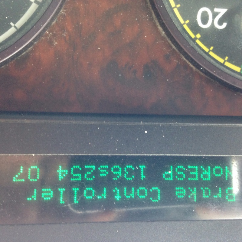

    I got this code and I have no idea what it is.
    Attached is the picture of the code.
    Brake Controller
    NoRESP 136s254 07
    any ideas?
    Thanks

    There is No ABS light on or anything else, just an active fault 1

    That is an ABS controller fault. The ABS may have a bad connection, or it could be a bad ABS ECU. Check for a bad connection at the ABS controller. Verify good power and ground at the ABS ECU. Hold the brake down and turn the key on? You should hear the brakes chuff as it goes through it self check. If it does, I'd check the connection at the data link.

    This code appeares if no responce on J1708. ABS unit may work, but j1708 wires are damaged (ABS unit is located in dr.side pillar, usually it is Wabco ABS-E (D+ in EU).
    J1708 wires is the twisted pair of grey and orange colors.
    I J1708 is OK, check ABS power supply. There are Kl-30 (batt power) and kl 15 (ignition power) fuses locatad in this pillar too. Open pillar door with quater coin, check fuses, look for sticker with fuse legend and check power supply.
    If fuse is bad and it blows when u fit new one - ECM is damaged with overvoltage, usually after jump start (i use to fix ECMs).
