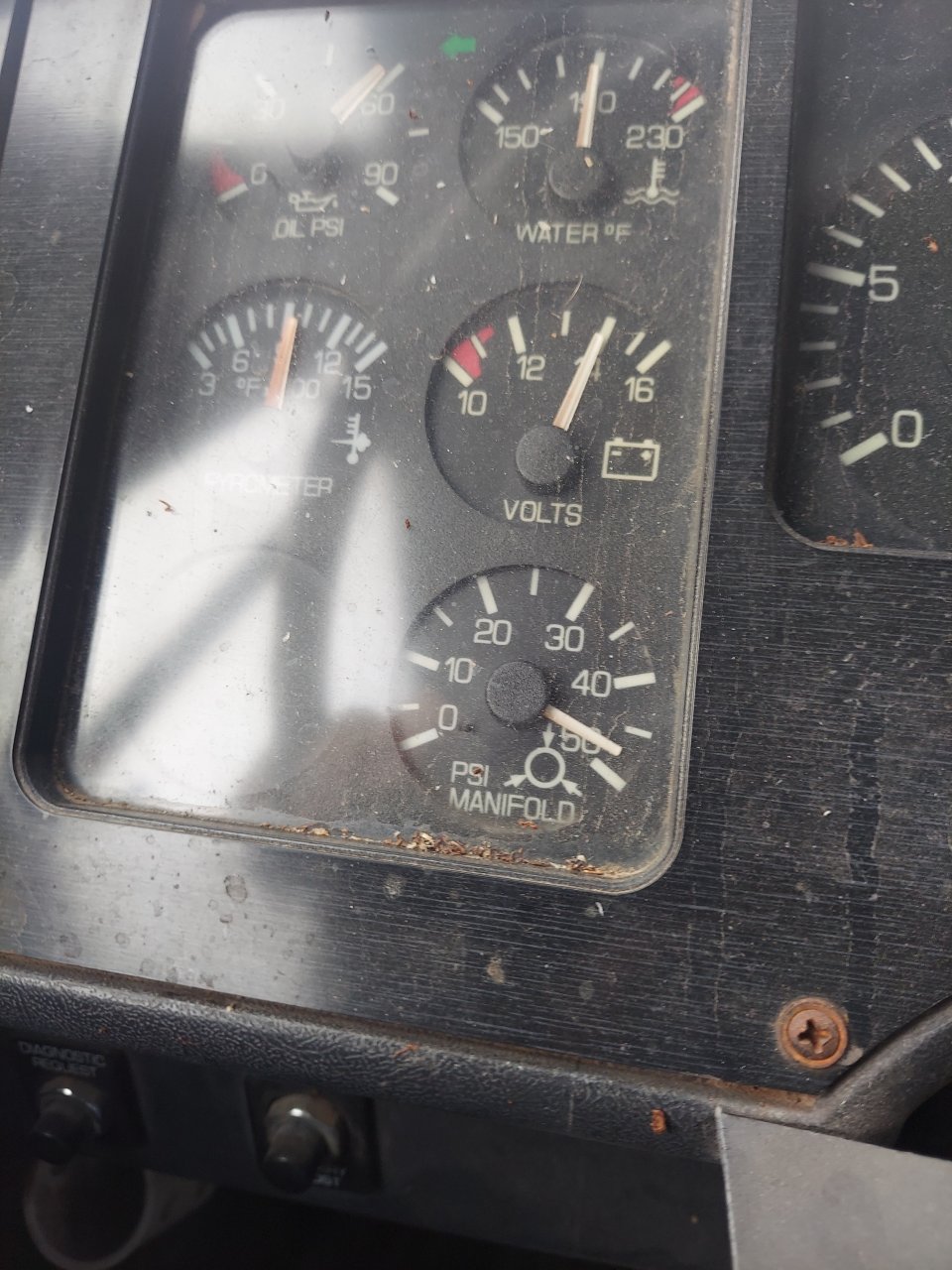

  5. Big Road Skateboard
    7,236
    41,217
    May 2, 2021
    You can also cause issues if you don't know what you're doing, or cause more work due to a tune.
    My little 325 horse 11.1 Detroit is tuned a bit hot, and took quite a bit more work to get it to where the ECM tune and engine performed well together.
    It's a beast now

  7. Big Road Skateboard
    7,236
    41,217
    May 2, 2021
    @Brettj3876
    Stock turbo was an S400, which IIRC was the 171702, is supposed to flow very good. It didn't work well with my setup. Max boost around 36psi
    I tried several turbos, and the K31 has been far superior than the others. That pic was at the top of the hill westbound from the Columbia in Washington. 925* EGT and I never let out of it from the bottom. 46k on the deck and only split top gear.
    Factory specs boost tops around 30psi.
