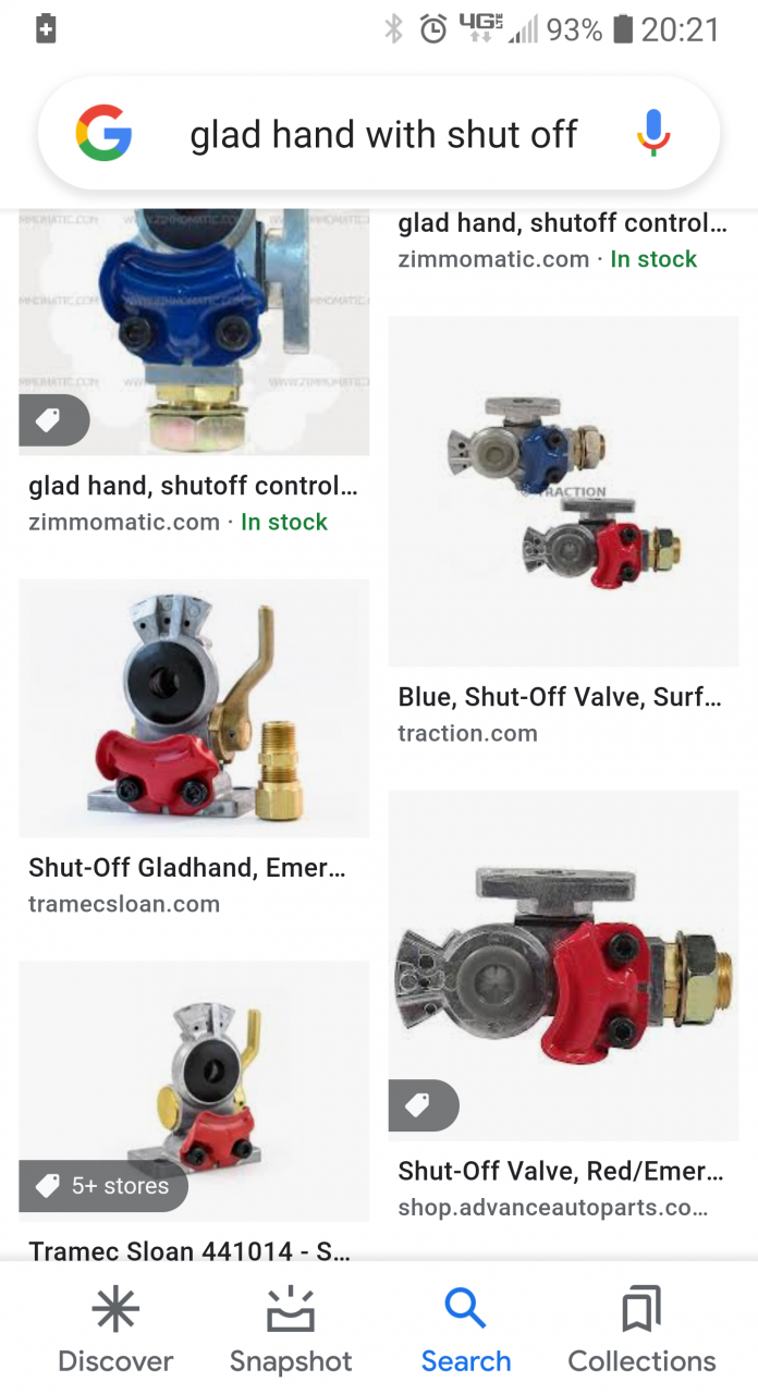

    Your buddies dump trucks probably have glad hands on the frame like this for the trailer to hook to... They have shut-off valves built into them.
    If he was to open those valves with no trailer attached... Then his red valve wouldnt stay pushed in either.
    Straight trucks and dump trucks are different than tractors.
