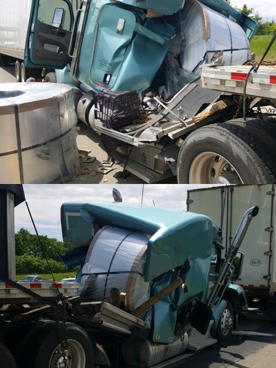

Driver make it?
Not sure, all Old Dirty Trucker posted was the picture. Comment section didn't have any details. Cab looks mostly intact, hopefully they did.
I can't see more than two chains that came with the coil. Probably all that was holding it. -
"Sneaky Sidekits" Aint the First-Wont be the last.
I just noticed-2 came in on him..lol you got 1 on the groundLast edited: Sep 7, 2019

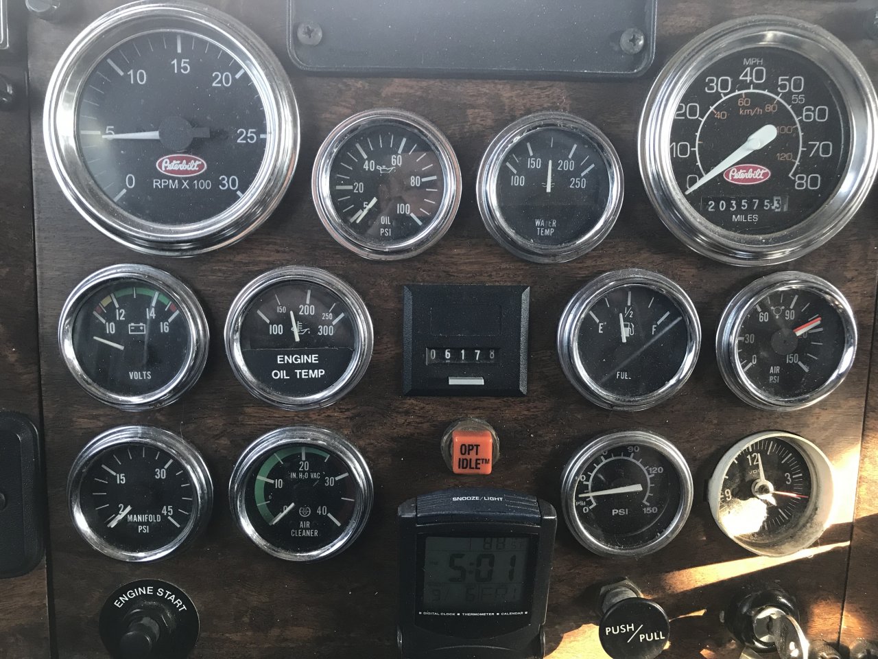

The light for optimized idle was a system to start and charge batteries, plus climate control. Poor detroit design at best. Most have been disabled by now. But it worked off a series of switches. Having a prolink and looking at switch status will tell you what one is open/closed not allowing it to idle up. There was a extra air psi switch on some to tell the ecm if the brakes were released. Equals no high idle. More common than not the mercury switch on the hood, which informed the ecm not to self start because hood is open fails. If it is still there buy pass it. The other is the TPS. While this may function just fine driving you need to see on computer if it actually shows idle position. The TPS is a multifunction switch that can also be a idle validation switch. This is from my memory and I have the books if we need to dig into this further. -
X2
Sorry, I'm late to the party. I typed this way earlier and now just sent it. @blairandgretchen all of you guys are on the right path. Good advise in here.
