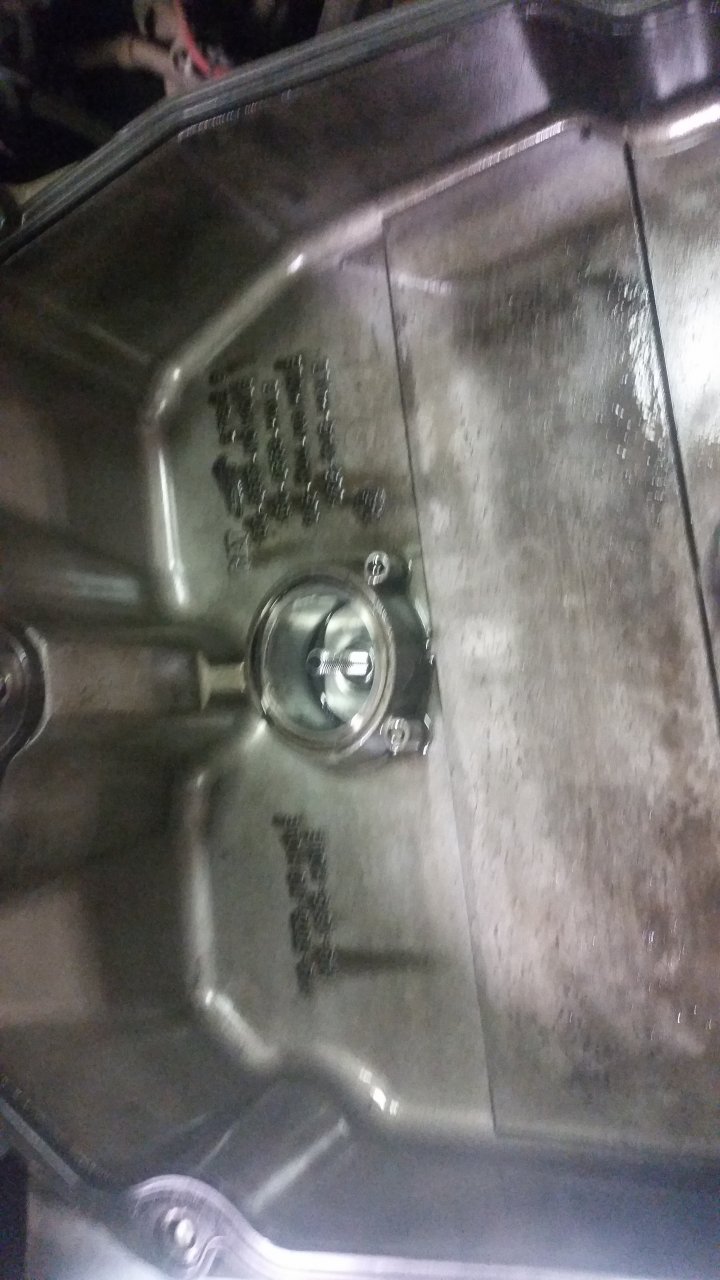

    20191015_104055.jpg Well, this Shaffers oil seams to be workin out....so far. Ran 320 miles monday half loaded at 144000 lbs. Oil temp was cooler, egts were bout 150 deg. Cooler. Lost bout 4 lbs oil pressure but I expected that. Only thing I didn't like was I had alot of smoke out the blowby tubes on a hard pull. Sales rep said that will happen the first oil change till the engine gets cleaned.....it may have been that I found the valve lash tight on my front rocker shaft. When I replaced the broke injector rocker I adjusted it but got lazy and didn't check the lash on the others on that shaft. So i did a complete overhead yesterday. When I took valve covers off this is what I seen. The black film residue is gone. This synthetic blend oil is doing what they claim so far.

    Interesting. I wouldn't have guessed egt would be much different. How do you monitor blowby on a hard pull?
