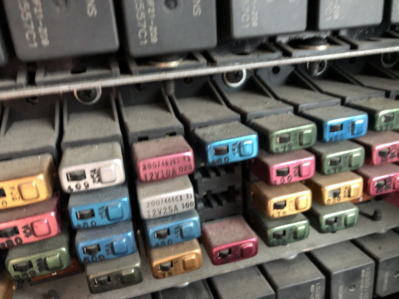

    @Tug Toy where are those day time running lamp switches located? I want to upgrade to led and google and forum searches didnt bring anything up for me.

    Are your lights on automatically now? Or only with the switch?
    If they only come on with the switch it’s no problem.
    If they come on when you release the brakes just pull out the f-9 b and c circuit breakers behind the glove box. No more problem.
    Or if they are on without the switch you can go to the dealer and have them programmed out I guess?
    Mind don’t have DRL active so not a problem for me. 1A780404-2B88-4100-B63F-7B8A6D856A31.jpeg

    Mine come on when I release the brakes. So pull those fuses and it's good to go?
  11. Tug Toy
    Tug Toy Road Train Member
    7,105
    74,333
    Jul 4, 2015
    Corn field
    That would be where I would start? No money back garrantee or anything though!
    Your fuse panel my be different but according to the schematics on the glove box.
    Days “DRL”
