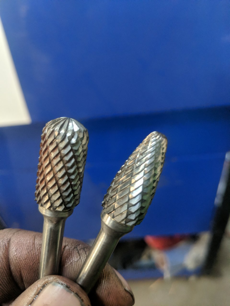

    Most fellas look at me sideways when I say I always soak manifold bolts with brake fluid before I even think about touching them....alot of people have good luck with the wax trick.... I've never needed to do it personally.
    If they're stainless like wore said to drill them you have to peck drill at .020 at a time and keep your tool cool.
    Carbide will get it but use lot's of soap and don't break it off in the hole or you'll be buying a electricfide blaster to get it out.

    Thanks , I might give that a try......Didn't think those Burr stones Would eat away at it... ..
    Good Idea though

    Usually a little heat and a left hand bit will do the trick... should a mentioned that before.

    Not if it's stainless

    Yep- Seems like it made it even more difficult....
    Im gonna try the burr stones and a pencil grinder- Then the left habnded bits.....
    Sorry Hurricane- Those Carbide Bits and Diamond Bits are out of my Budget at this time $150 a piece

    Get you a couple of these
    It takes time but they usually do the trick
