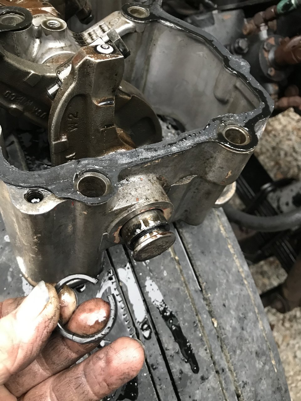

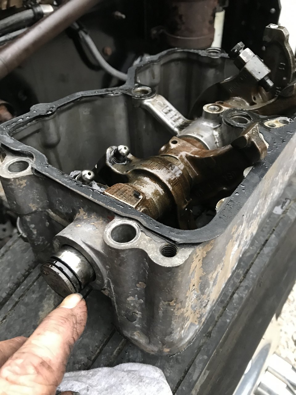

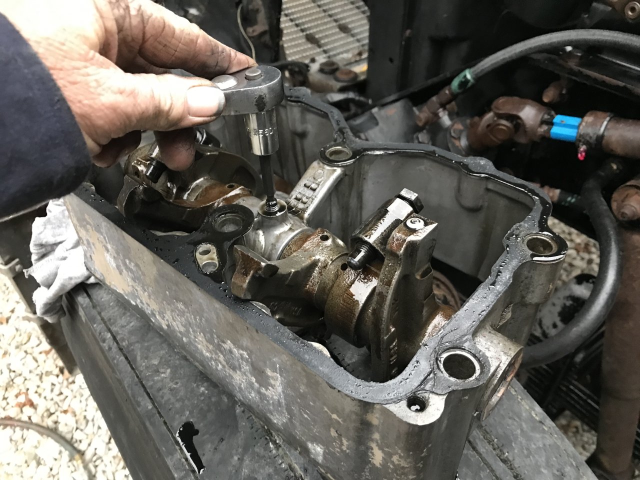

    Usually doesn’t pay to assume or overlook little things.....:( found a couple oil leaks since I been running the new Hillbilly Hotrod as @superhauler called it lol. I took these rocker boxes off the original engine to the truck and had them cleaned up waiting for use. Seems the O-rings in the rocker shafts are all leaking, so hard they broke trying to get them off, so a little back tracking it is.......

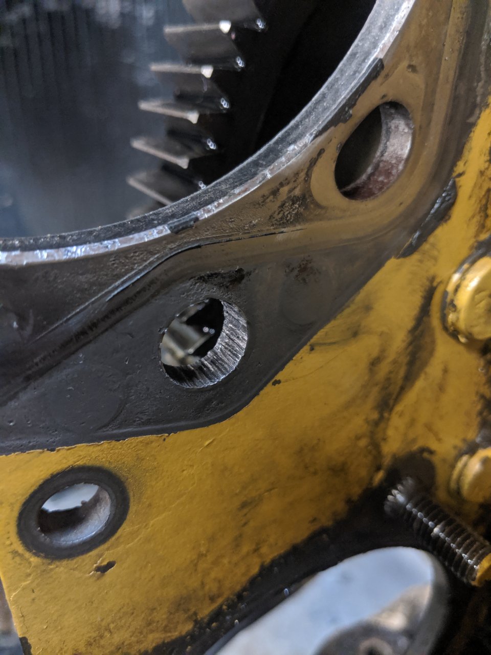

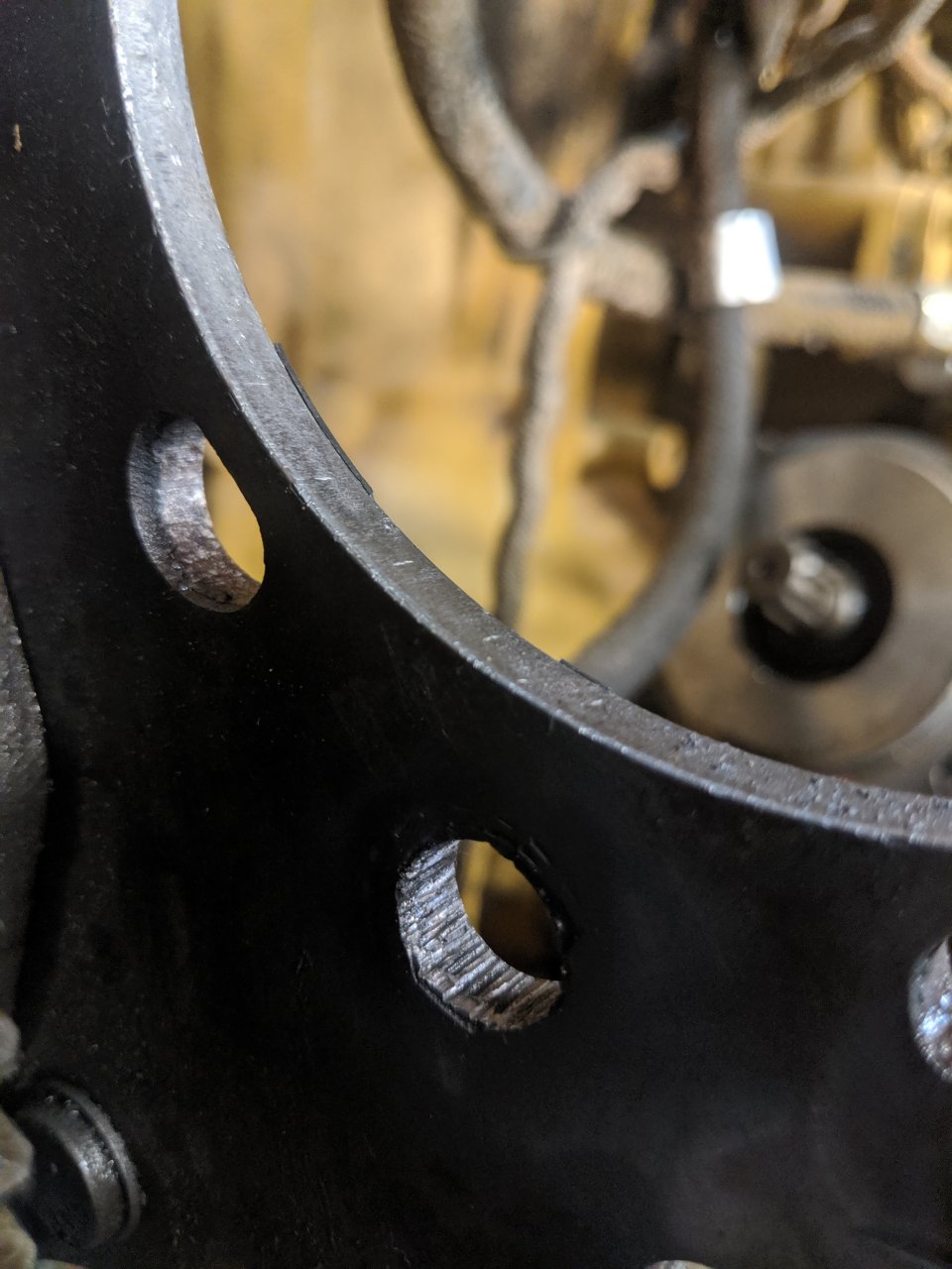

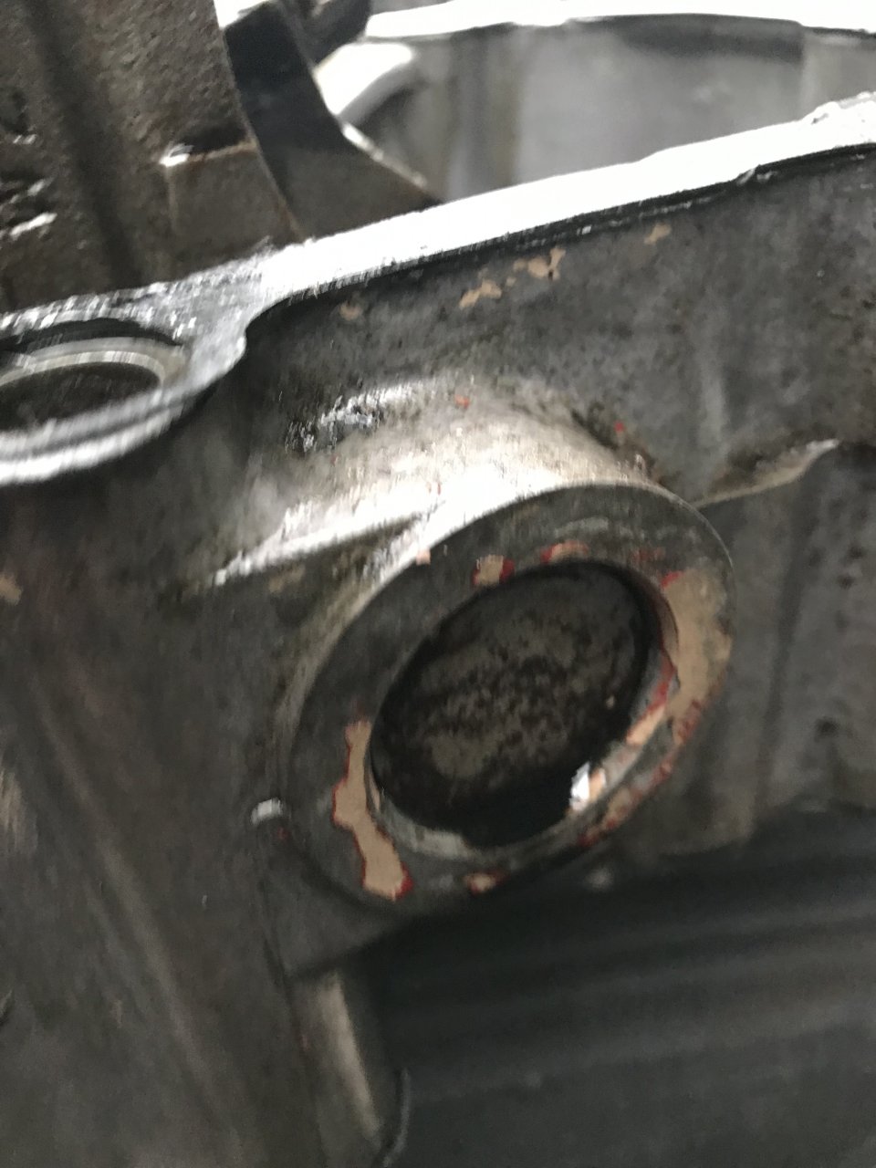

    You might be right but the grinding of one side flat enough to get past the idler gear has a lot to do with it. New stud fits snug in the hole, only goes in halfway by hand so once I draw it in with the nut it should not leak.

    Eh, minor stuff......it'd in good hands.

    You Gonna take that intermediate plate off the block and reseal it as well ?? The stud hole looks ok but that buildup of metal on the oil side looks ruff. Maybe grind it flat before you tap the new stud in. I cant remember, does those studs use a copper washer to help seal them ?
