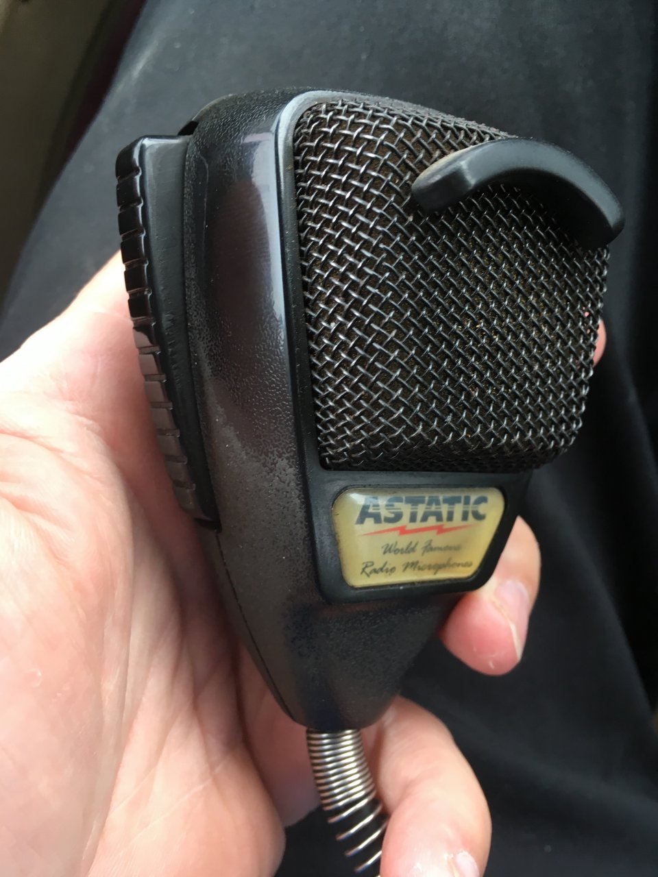

That's what I'm working with. The CB shop cleaned the mike 6 months ago when they did new coax
It crackles when you key up, and apparently whatever I say is breaking up. Buddy yesterday said I had lots of juice but no clarityCrusader66, Shock Therapy, 1951 ford and 8 others Thank this. -

Probably a broke wire in the cord. You can have it replaced for $25 or so, or just get a generic 4 wire microphone cord for around $10 and solder the connections or have it done. That 29 you have is a good radio.Crusader66, Opendeck, Shock Therapy and 6 others Thank this.
99 percent chance it’s either the cord or the button. A jewelers screwdriver will take the cover off the mic and you can spray some electronics cleaner if it’s just dirty (we have a lot of those problems in my line of work). If it’s the cord it’s usually just as cheap to buy a mic unless you’ve got an old cord laying around.
And don’t overpay at the truck stop. That mic can be had new on eBay for around $25. Same with the Ranger, which has become my favorite the past few years.

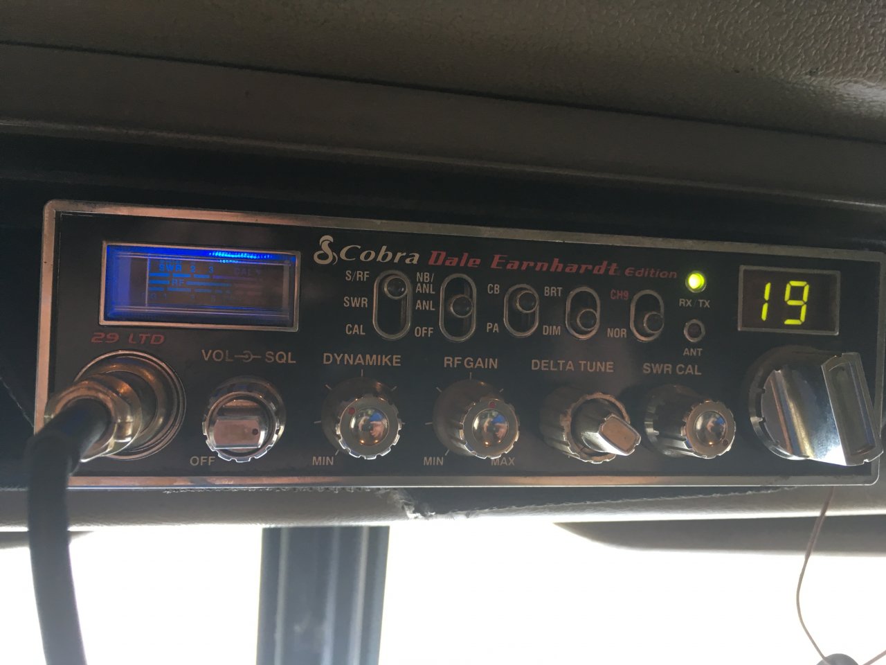

I run a Cobra 29 in the truck, with a small box behind it. Good little radios, and simple to work on. Looks like you’ve already got the echo board in your Dale Earnhardt edition. That’s a nice little rig.SAR, Crusader66, sawmill and 10 others Thank this. -

Single final, same as the one I had back then. Shoot I don’t even really care if it works, I’ll probably not even put it in the truck. Just be cool to have on the bench.
