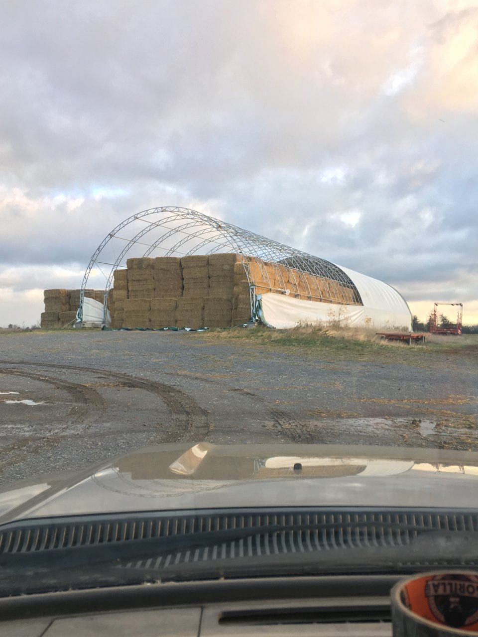

    Know where hay is next shortage. You think you have enough?

    That’s straw and no we don’t have enough. Could probably sell 2 or 3 x that amount. There’s about 425 tons exposed to the elements there now. I hope we can get a new roof on there quick because I don’t want to move it.

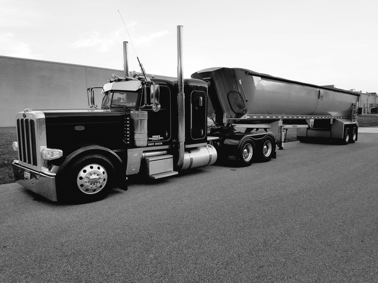

    This was the lightest large unit I ever drove...Mid to high 28’s empty weight depending on fuel level..Series 60, 18 speed, 3.36 rears, coffin sleeper, small tanks, with a Mac half round behind it..
    *edit* disc brakes truck and trailer
    25 ton in the bucket all day long *legal*.. :confused3:

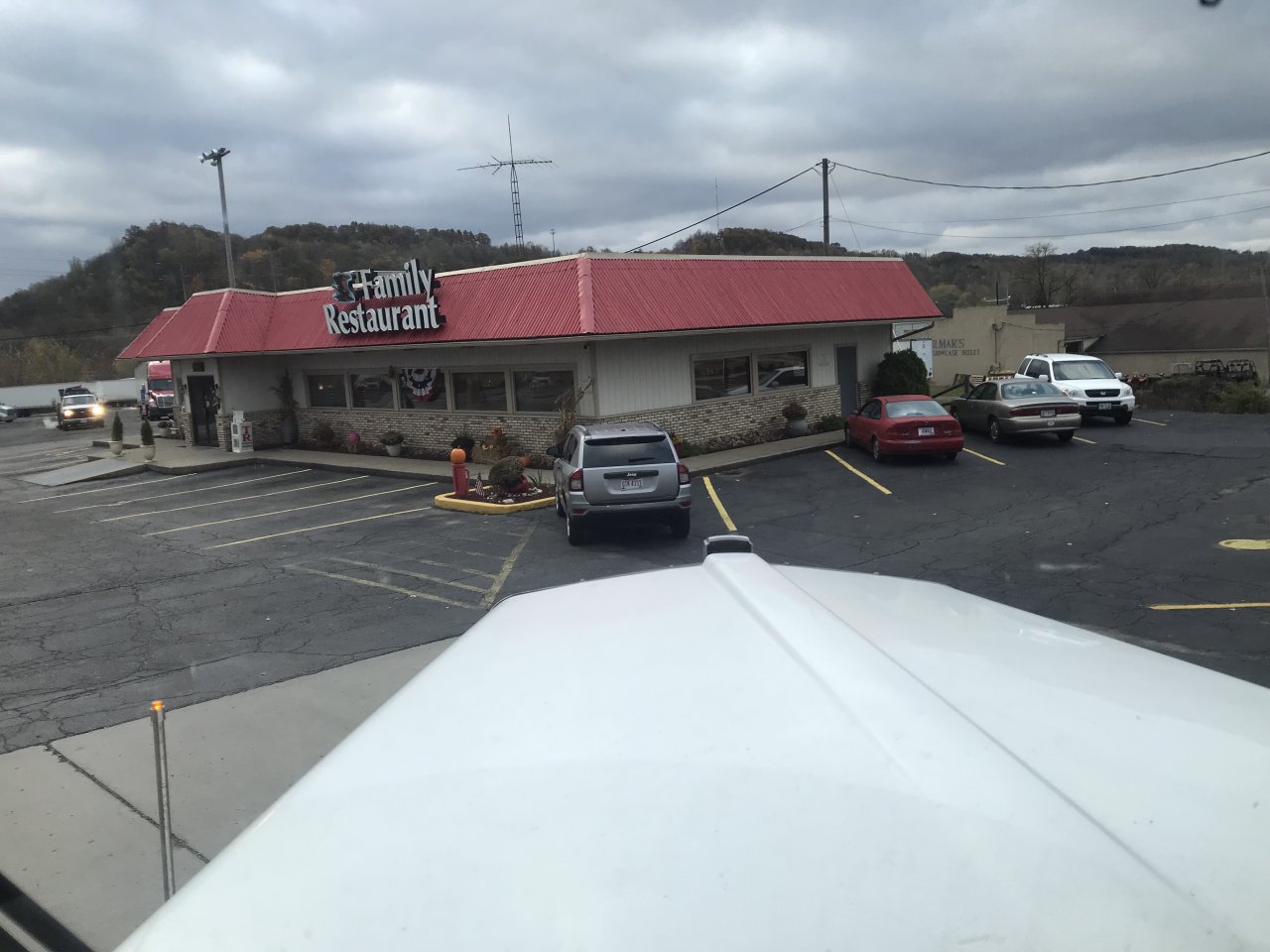

    I see you parked across the laneway from the Cascadia crowd....
    Have a thing against red fruitsniffers, pal? Do ya? DO YA?!?! :D
