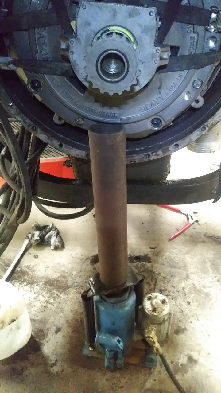

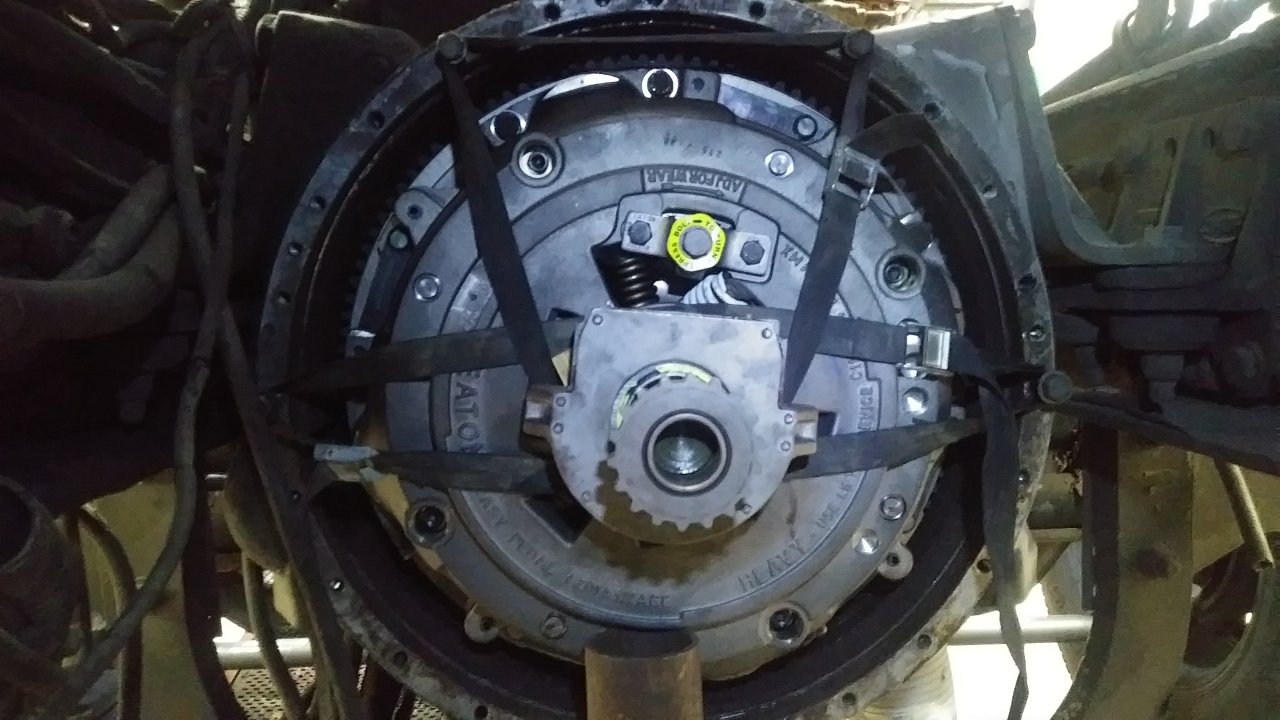

    Wrestled this guerilla for quite a while today. Finally wooped it.

    Gonna give you a quick tip. If that engine has not been turned over. Unbolt the clutch and put the adjuster to the bottom. If it has. Remove and start it. Run a few and shut it off. Then put adjuster at bottom. It's not 100% but if you do. About 80% of the time that engine will shut off with the adjuster at the bottom ready to adjust or darn close.
    This is the level of lazy I'm at I'm my life.
    Edit, leave alignment shaft in. Get that belting and jack off of it loosen bolts and retorque bolts.
