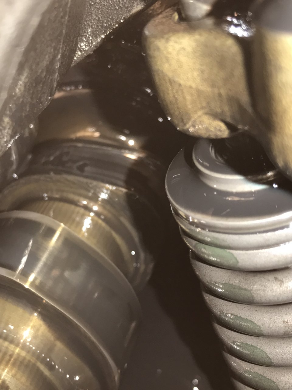

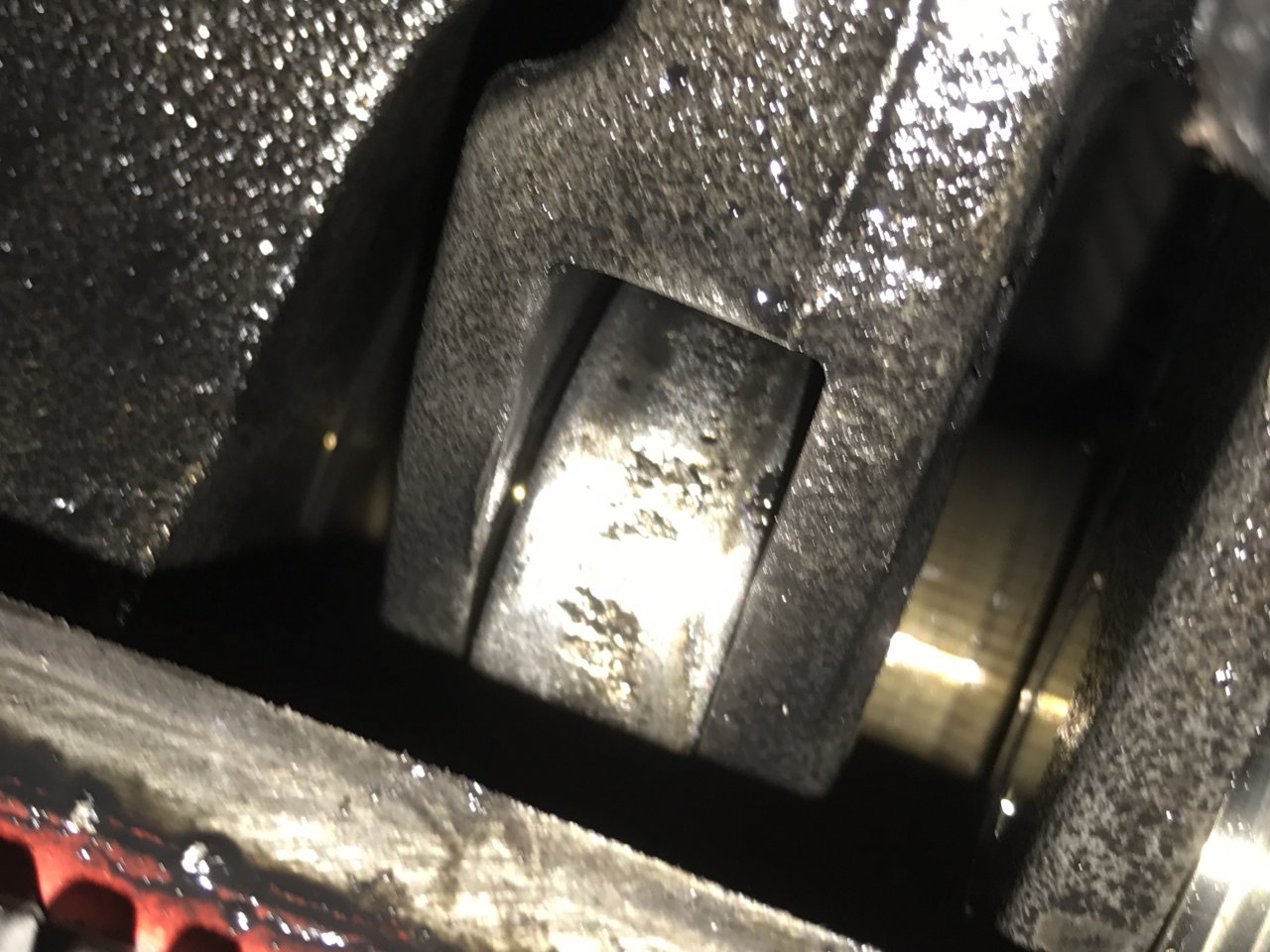

    Wow, that lobe looks scored much deeper than mine.
    I only took the one pic, but 4 of them looked about same. Visible, but very shallow. I asked about doing the overhead without the a new cam & they didn't want to do it. They said put it back together no adjustment & run it, or order parts. I did not say yes yet, I wanted to think it over. Maybe I should just take the gamble & run? Now you've got me nervous about them screwing something else up..
  5. jamespmack
    On the series 60, before you do anything just look to see if any rocker adjuster screws are sticking up taller than others. They tend to have valves sunk in the head with high milage
    Always check that adjuster tips are there.
    This is the updated style. Not normally a problem. But make sure that tip is on it.
    Can't find a pic, but the original style was multi piece with a clip that would break and people that didnt check would adjust it and it would beat the hell out of everything.
    Either way when you have alot of that thread sticking thru and above the rocker arm body. You need to look further into it.
