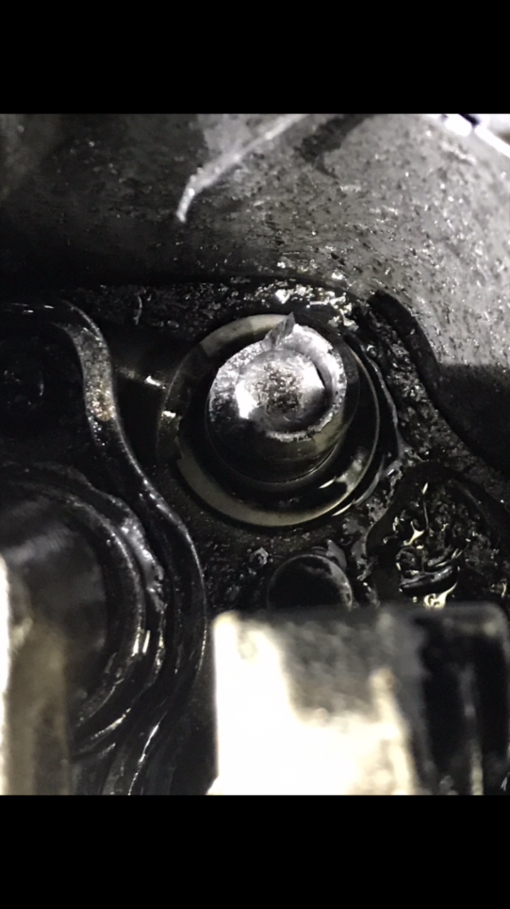

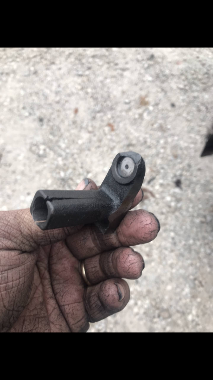

    Fighting a couple gremlins.... had to do some thinking and looking but figured out what caused a “close call” for me!
    Had a valve stem break just below the keepers, valve dropped but piston smacked it back up numerous times before it fell through the guide. This broke 1/2 the guide off and battered the broke edge of the stem.... ( thank God!! ) the battered edge held the valve in the head. Talk about a head scratcher..... how do you get it home over 200 miles on its own power in this shape...???? Anyone????
    Well I did! Took a little thinking but I made it run on 6 cylinders still and drove her home!!
    Number 3 intake valve... 1 of 2 intakes for that cylinder with a broken stem, how do you make it run on 6 cylinders and drive it over 200 miles...??
    I’ll let y’all think about this, what would y’all do?
    Keep in mind only the first 1/2” of the stem is missing, and the crosshead is broke.

    Yes, twin turbos & A for aftercooler.

    Im thinkin you did something to the rockers and let that dead hole be a 3 valver...
