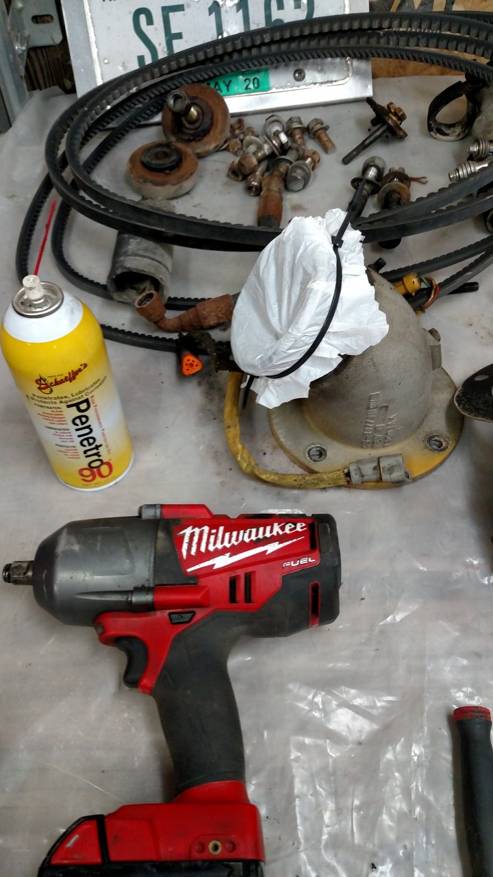

    I've went to doing this so that doesn't happen.

    I don't know how well this shows up in a picture. Gonna put her back together when I get the head back from a shave but we's gonna be running on borrowed time.

    Yep. Always have a count on the rags you stuff in a hole. I can the say a Cloth shop rag will go thru the geartrain on a 97 series 60 Detroit, make it from Clyde, Ohio to Chicago, IL before it sucks it up the oil pickup and shuts it down for low oil psi. No damage done. Had to have a chat with that guy.

    When you get older and spend half the day trying to remember where you set down your cheater glasses you mark everything. I'm pretty meticulous on laying things out like they came off even thou I've done this a few times.

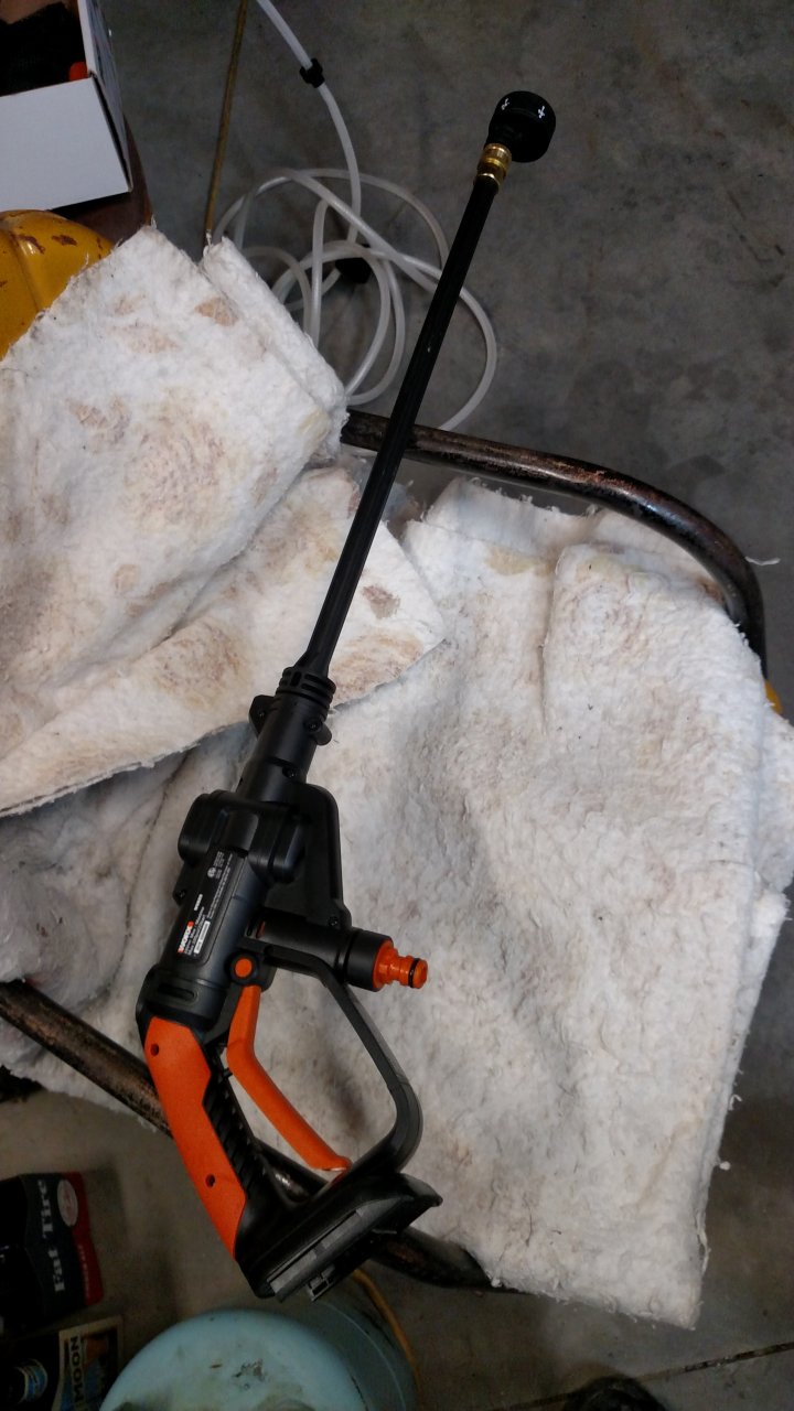

    I bought it at Menards but Amazon or their website. Worx pressure washer. The bottle adapter is sold separately. I wanted it for bugs in the summer and cleaning the back of the trailer in the winter.
    It would work great for cleaning your and doc's boots
