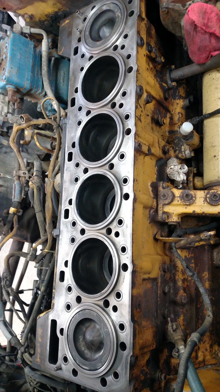

    Only went a few miles, but she seems a bit stronger.? (Pulled my mt trailer home) No smoke on startup, or idle, & only a faint haze hammer down for 1 second or so. Used to puff a bit when 1st fired, & haze a tad at low idle. Also idles much smoother, & will be adding the 2 stroke we spoke of, so that should help out too..

    Had to fix that .... .349-.350
    Oldheimers disease...

    Sure it ain't .00349 - .00350 ?

    Fixed it...loose the zero...off the deck.

    Actually add another zero...... .003 is three thousands. .00350 is three and half thousands.

    Off the deck is supposed to be .350 without spacer plate

    Oh without. Do it with spacerplate and tin gasket with hold down bolts and fiber washers. You might be surprised !!! That will give you a more precise measure.

    @Hurricane69 just asking. When you did that measurement, did you have the liners held down with bolts and washers ? If not those measurements won't be true.
