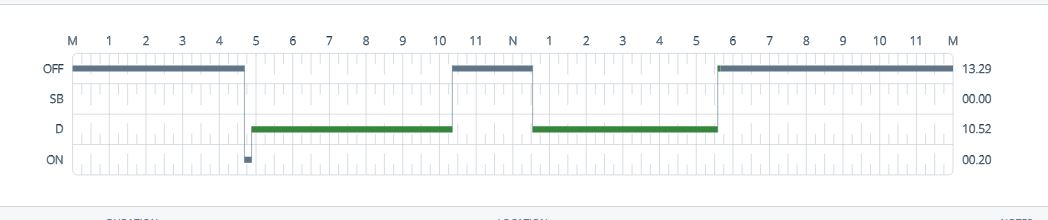

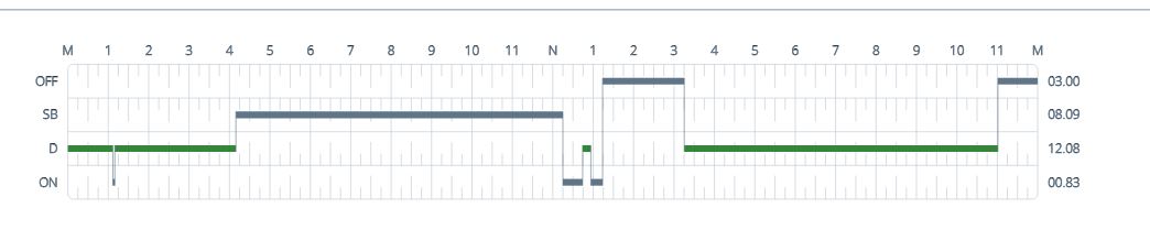

    those graphs wouldn’t fly at my company and you’d be getting phone calls from safety.
    not trying to start a FMCSA war with ya — just stating some of the rules the safety department here likes to look for. They wanna see a stop every 3-4 hours to kick tires, etc etc.

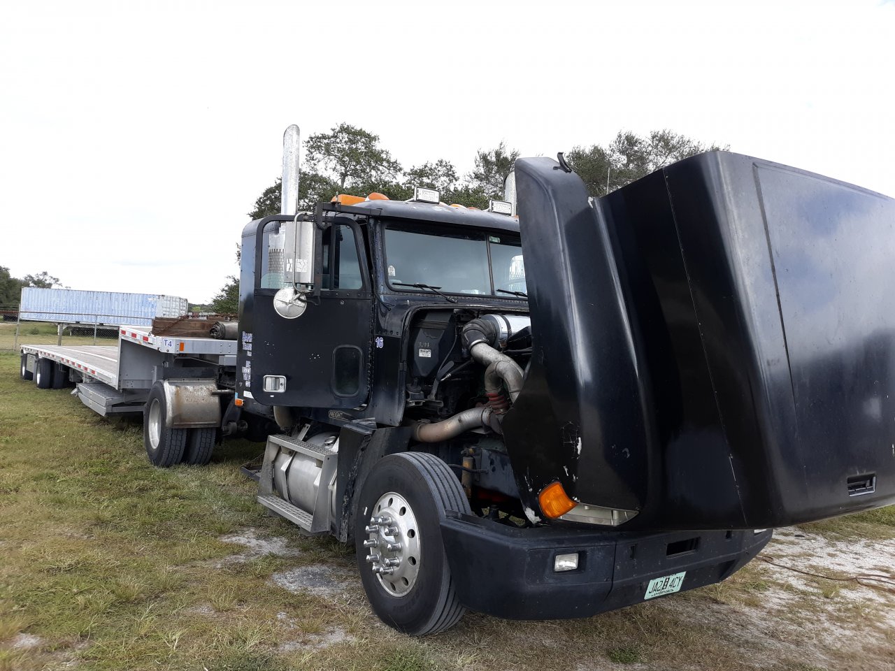

    Welp, as some of y'all remember I just had a cam put the series 60.
    While running bobtail seemed fine. Deadhead with trailer seemed fine till I hit the big hole. Hammer down she starts puffing gray smoke, with almost no acceleration. Sounds like it missing. Pulled to a safe shoulder, & started lope'n & huffing clouds of gray smoke. Drained water separator, & spun on new primary & secondary. Cranked up fine. Thought I was back in business. Hammer down, 1-7 all good. Big hole she starts missing again with a gray cloud pouring out. Kicked to neutral, the same lope & gray puffs..
    No codes being thrown.
    Bad injector?
    Or did they screw up somewhere in the camshaft r&r..? FML

    Knowing what you just had done, I'm concerned they got the cam out of time. Hmmmm. Or someone used the old out dated valve set adjustment. Timing Circle procedure will drop valves and is out dated. Valve overlap is newer correct procedure.
    I guess start with the little things, makesure all fuel lines are tight and may check cylinder temps looking for a cold one.
    You didnt change injectors did you?
