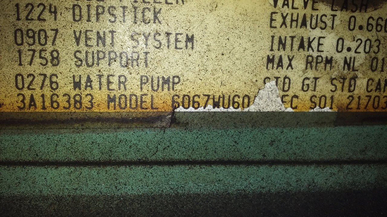

    I've actually argued with him a bit. He said I had a ddec 3, when my model # denotes it as a 2. As per the info you posted a few days back, & my own research as well. 0124181259.jpg
    Can't remember, but I think it's the U that designates a ddec2. W is 11.1L.. Build date is 09/92.
