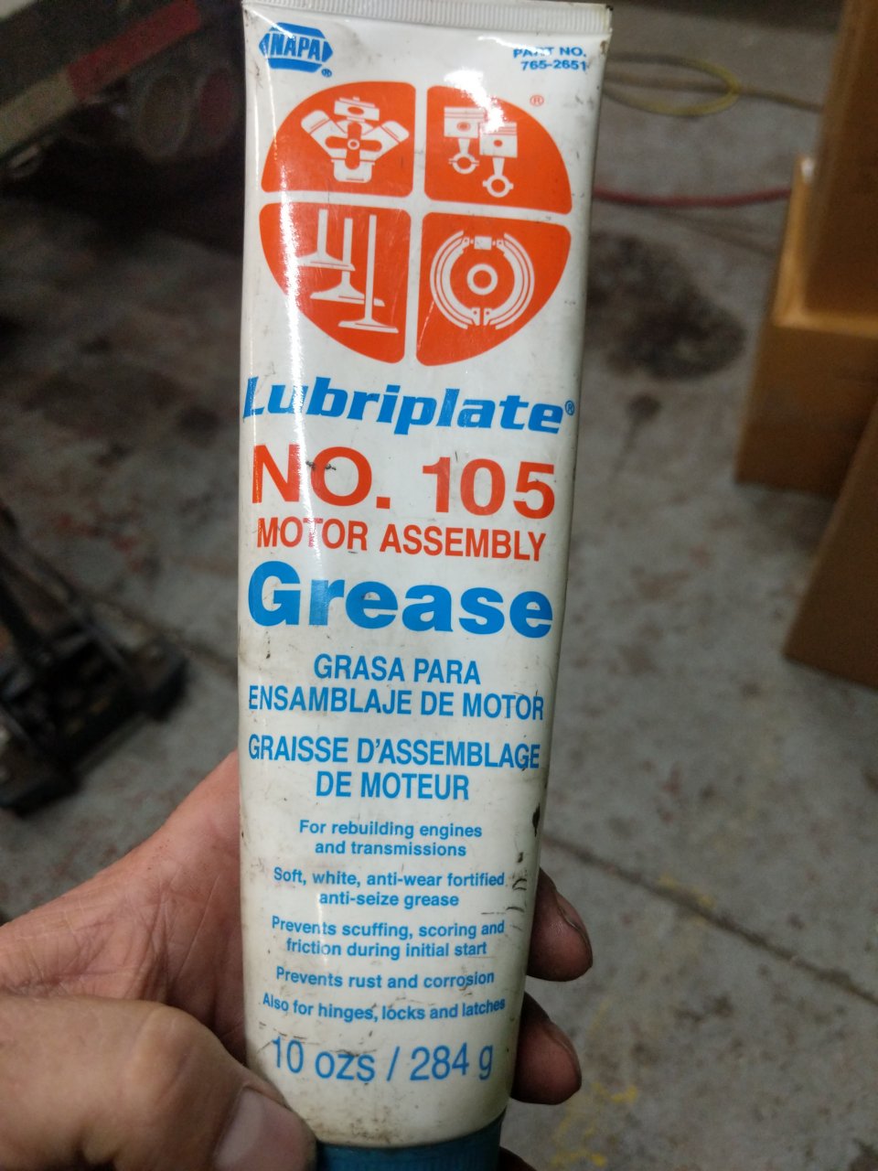

    Not a fan of that stuff. Its ok if you're going to put it to work right away but that stuff turns to the consistency of drywall if it sits too long.
  5. sawmill
    sawmill Road Train Member
    3,994
    73,167
    May 29, 2015
    Evanston, WY
    I didn't know that. I guess I've never used it on anything that was going to be sitting for a while before getting used.
  6. AModelCat
    29,778
    165,576
    Yeah its weird stuff.

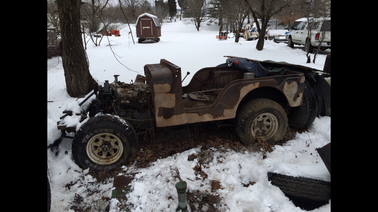

    @AModelCat here’s some food for thought......
    This Jeep I’m rebuilding was last ran around 1988-89. Until about a year & 1/2 ago it set outside covered up.
    When I pulled it apart to replace the front and rear crankshaft seals, I found oil still in the bearings. Wish I would have taken a picture now..... :confused: that being said, if it’s going to be inside covered up you will be ok with just oil.... even 80w-90 smeared on the crank journals would work..... I’ve done it myself.
    The engine in my truck (Kenworth) I replaced a plug in the oil galley with a JIC fitting with a cap on it. I have a small hydraulic 12 volt pump that I hook to that JIC fitting and pump oil under pressure to the whole engine before trying to start it......
    Something to think about.
