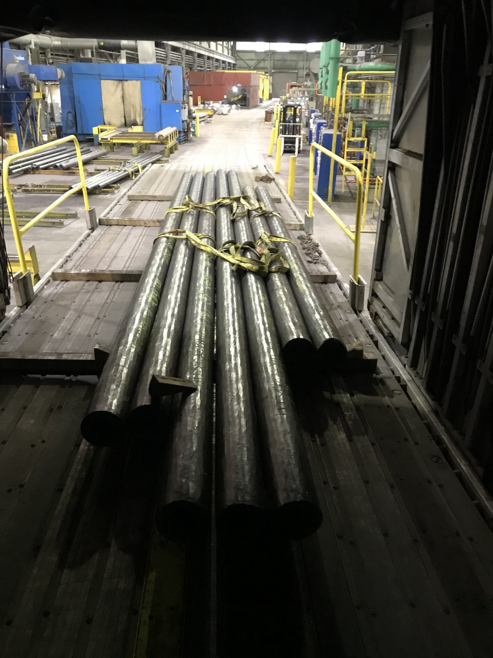

    Within 20 miles my tarp is blowing all over, see if this helps...
