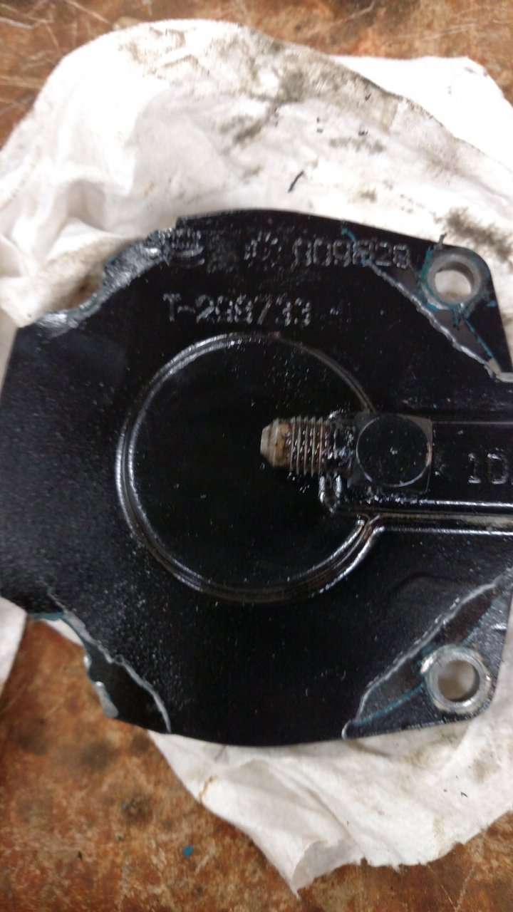

    OK
    That sucks but I know the feelin.
    I changed my air compressor back this summer I took it all apart got everything I was gonna replace loaded made the 45min - 1hour trip to the parts house got everything came home and started to put it back together and broke the #### adapter plate..... ####.... another #### trip to the city.

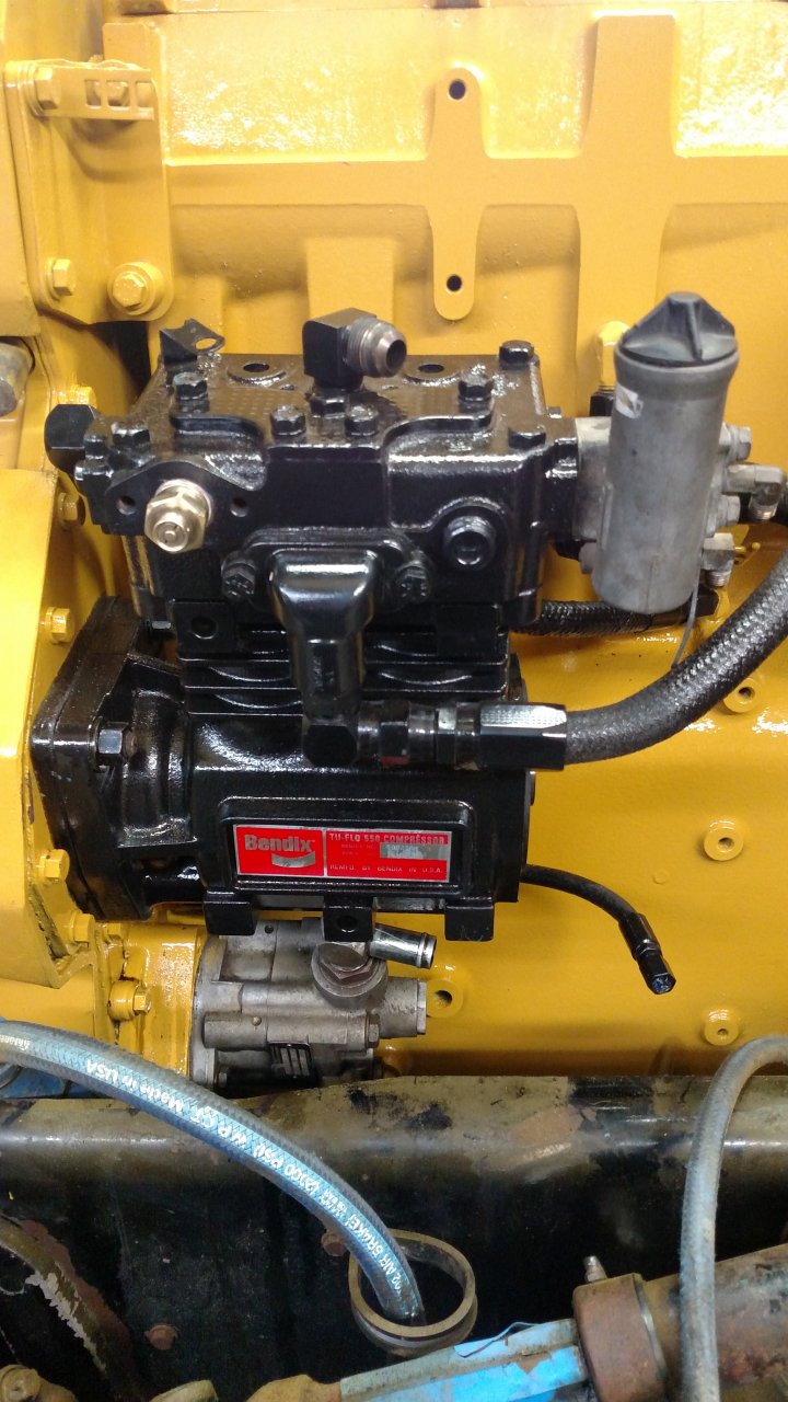

    keep stroking.
    Um, FYI, if you find one be careful trying to installing it with the comp already mounted. The comp crank will be off center hanging on the engine with that cover off. It can be a pain sometimes trying to put the end cover back on. Dont ask me how I know this ! Ya might get lucky and it will slip in. Be careful don't force it when ya do !

    The old one slips easily off and on so I should be good. There is a tab on the thrust washer that has to go in a groove on the end plate.

    Yep.
