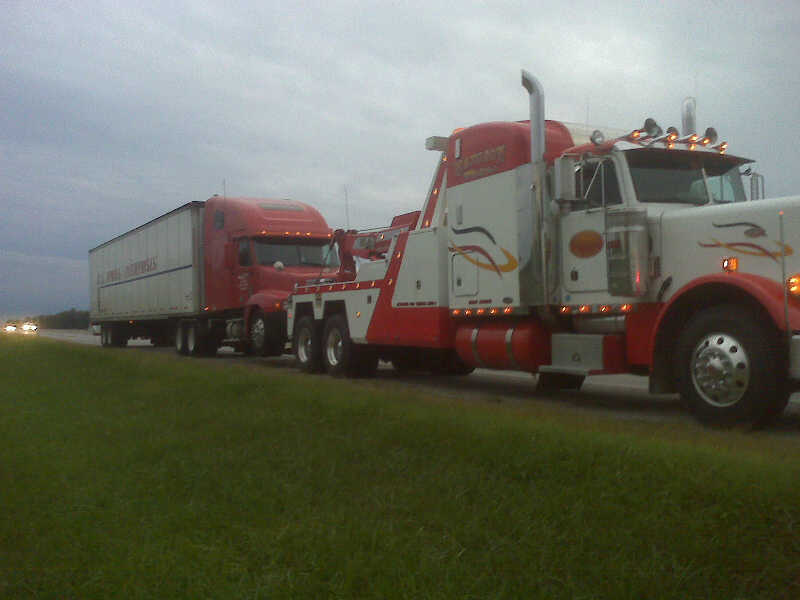

    130 or 140 pages on my desk. But who is counting.
    @hurricane
    On the pete suspension. Low or Air leaf I have seen on long wheelbase eat bushings. It was in wreckers mostly. But they were abused. Just kept them in stock. However just like the airliner I found of it's not holding bushing it normally was the hole you put them in. Not the bushing or application. On a Airliner if the bushing dont go I'm hard, you need to replace the spring.
    Like anything, never let the bolts get loose either. Or oil contamination.
    To this day my favorite truck I ever drove. Not the biggest. But probably the fastest. At 320wb it was hard on stuff.
