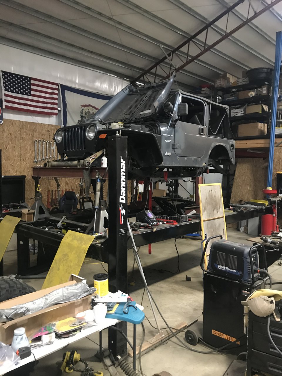

    Machine shop... lathe, milling machine, cnc burn table, shear, metal brake (to 1/8”), powder coating oven, just “stuff” like that..... :D

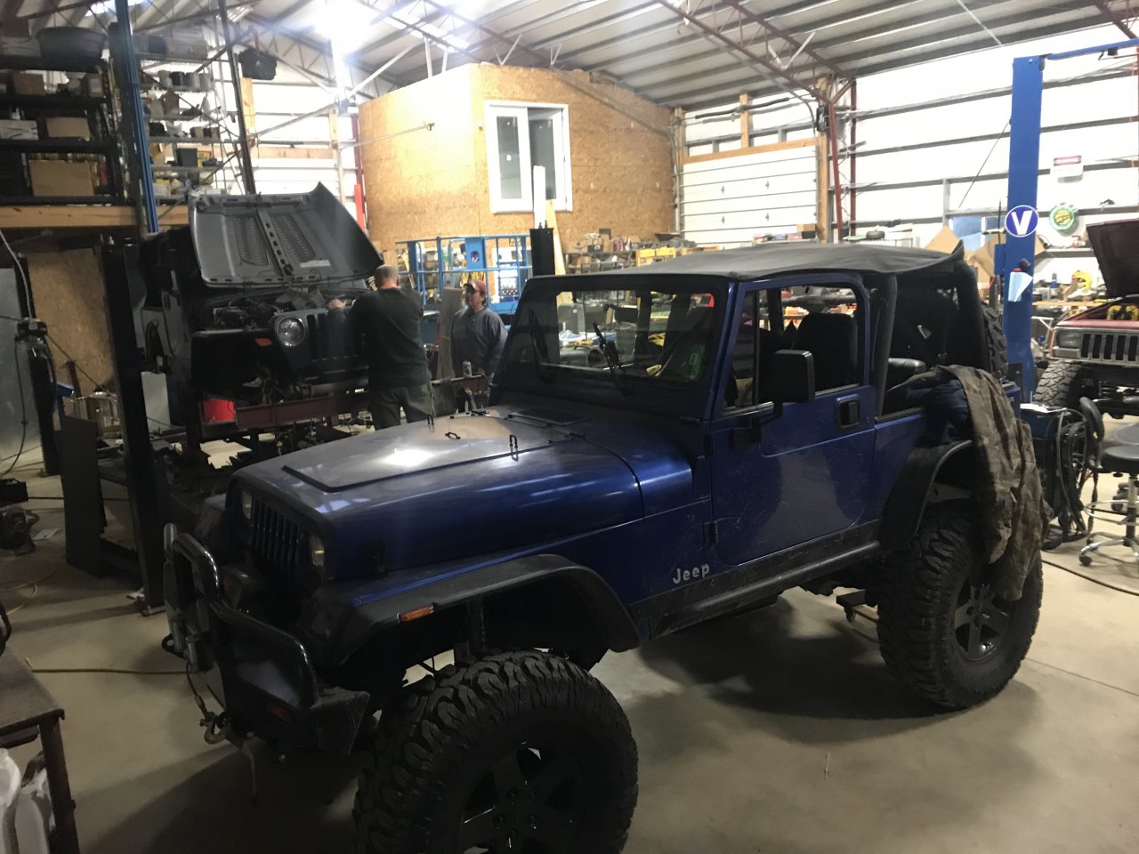

    Actually this is a area with a vending machine, and another section with a bathroom. Over head is like a office with storage. 333136A6-D82F-43AD-8E4A-F2220D8F0FB9.jpeg

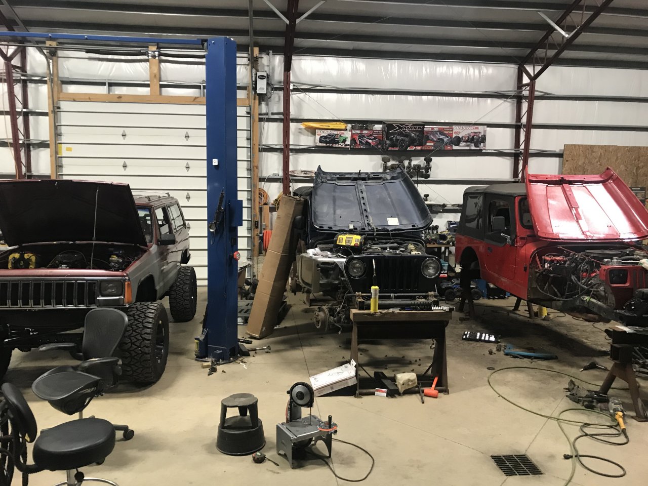

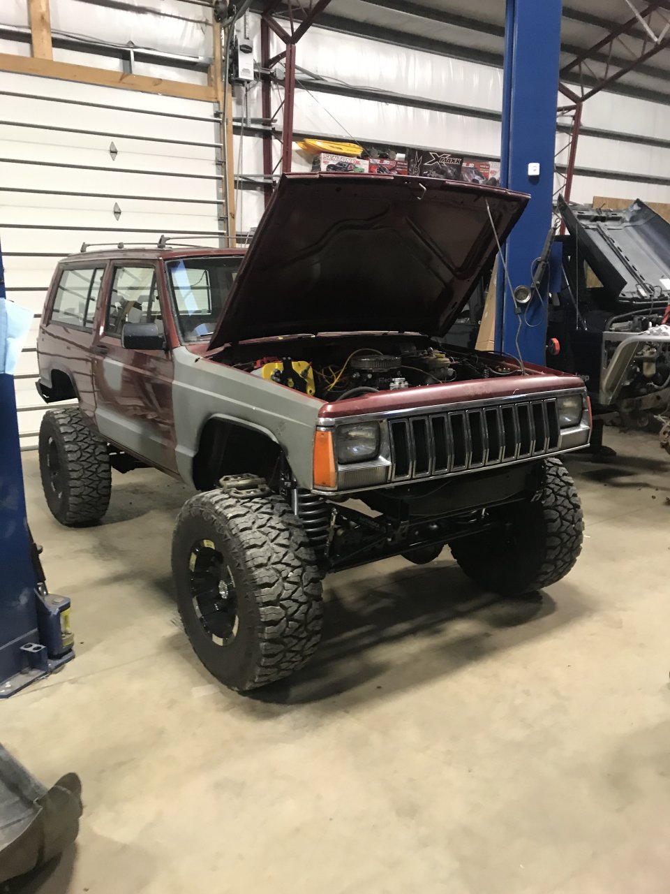

    D7853B1F-CB35-468F-9CE5-5B558E628672.jpeg The area behind this Jeep is where all the metal working machines are.....
