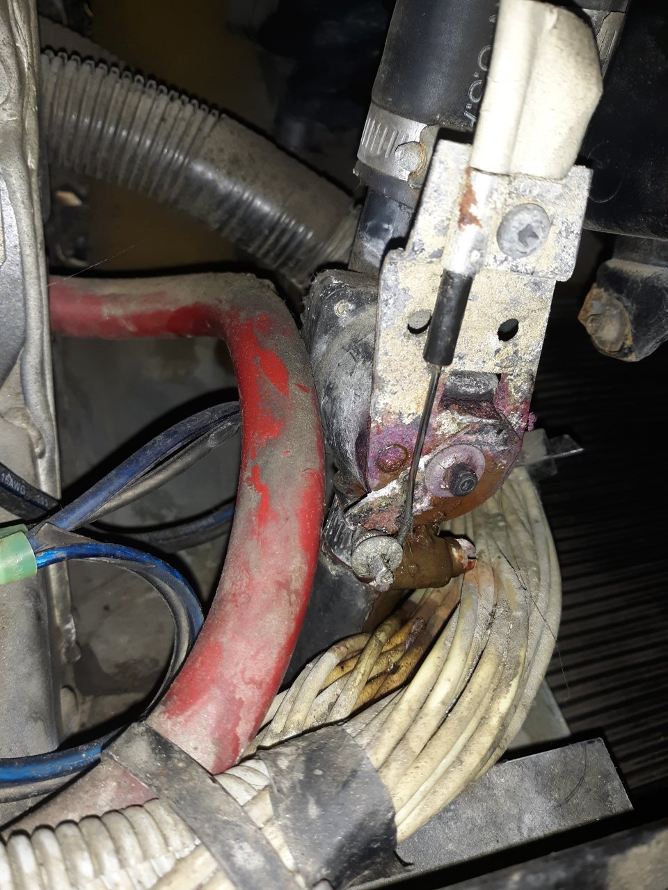

    Heater valve. Means of stopping your coolant from circulating when you are using your A/C.

    Thanks! So it's just called a heater valve.? Dont like sounding like a complete mook when I walk into the parts house.. :D
    Seems like I can tackle this one myself..

    That’s what I always knew them as. I don’t hardly use mine, I use the valves out on the engine. Sometimes they will bypass internally and keep the heater core warm, really effects the a/c!! Probably behoove you to look on the engine and turn the main valves off if so equipped...? If not that’s a lot of antifreeze to deal with when you pull it apart. I have pinched the lines before with visegrips and a couple pieces of wood.

    Yup, its gonna be a mess alright. Unfortunately I do not have valves under the hood to close off the flow to the heater core. Visegrips & wood will have to do. Maybe during this project would be a good time to add them in..
    Only has gate valves on either side of the coolant filter.
    I've also heard quarter turn is preferred over gate. Is this true..? Like to add on the best kind I can..

    Oldskooler got you. Sorry I was vertical. And yes adding valves will actually help A/C in the summer.
