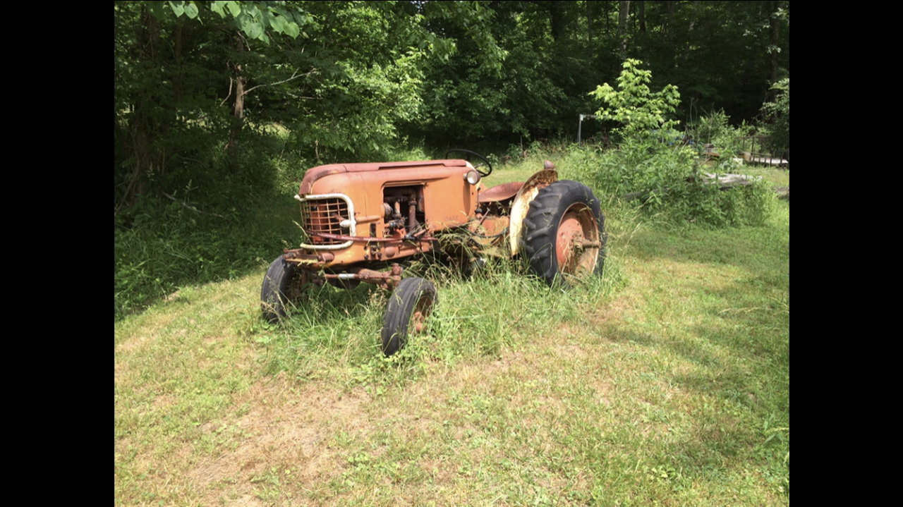

    27E6FA05-D712-4407-A0E3-8938E7F443AF.jpeg 5C7533B7-A1AB-447B-B79C-24031428D754.jpeg E5916279-F3FC-4053-B7B9-5D0C284120A3.jpeg 029D5AB7-A23E-449D-B189-91348A6F57AC.png

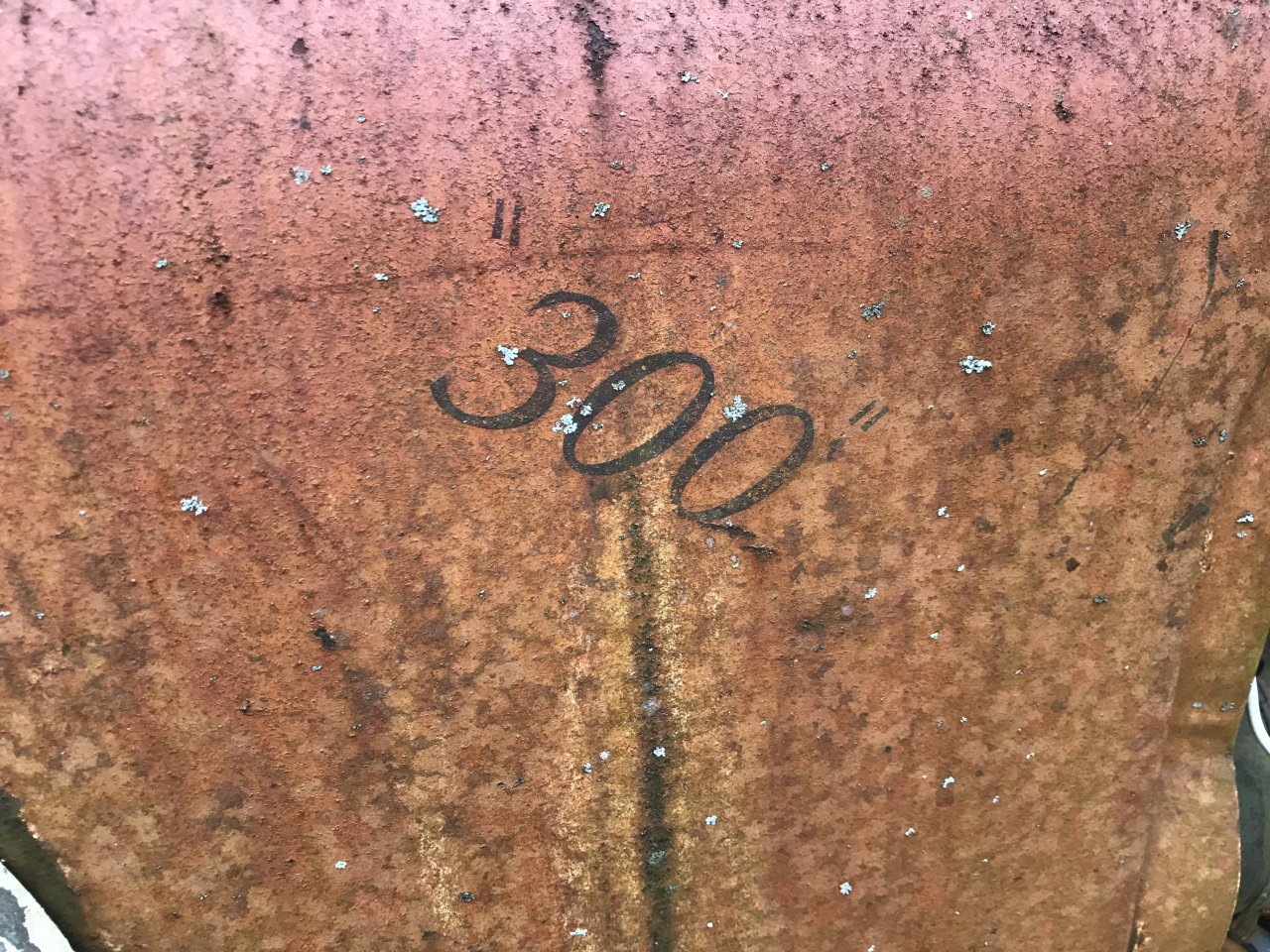

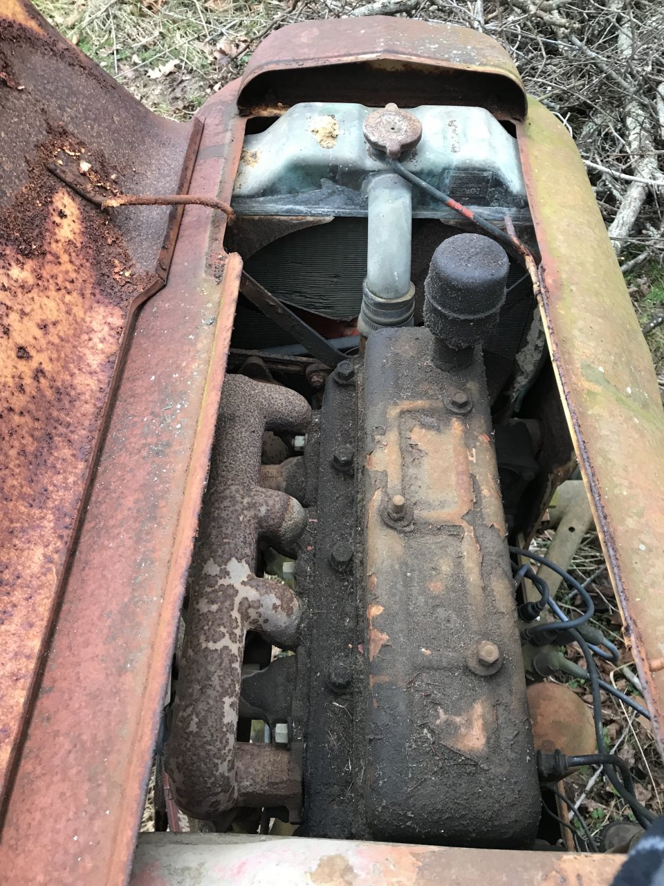

    It’s one of 2 things I own that my wife has no clue about me owning, I drug it in from Hopewell, Virginia a good spell back lol. It is in its original work clothes with the writing still visible on the sheet metal. With a 4 speed transmission and a 3 speed range selector they were pretty nice. Built from 56 to 58, and with live PTO and live hydraulics it was new technology for Case compared to the VA series. They were referred to as a 300 Roundnose....

    What would the "300" be referring to?
    So, with the motor running the pto would be turning, or only when it's in gear

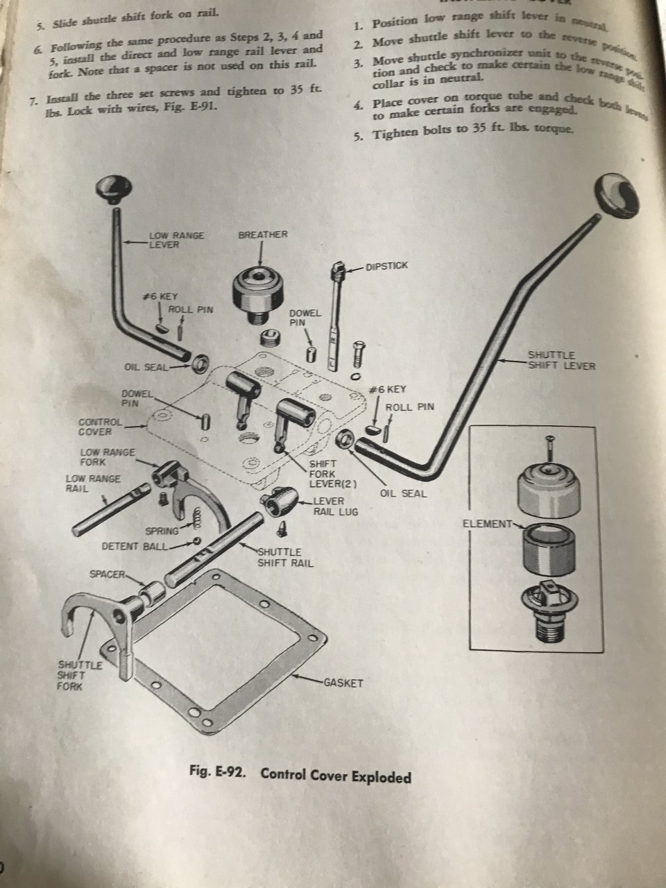

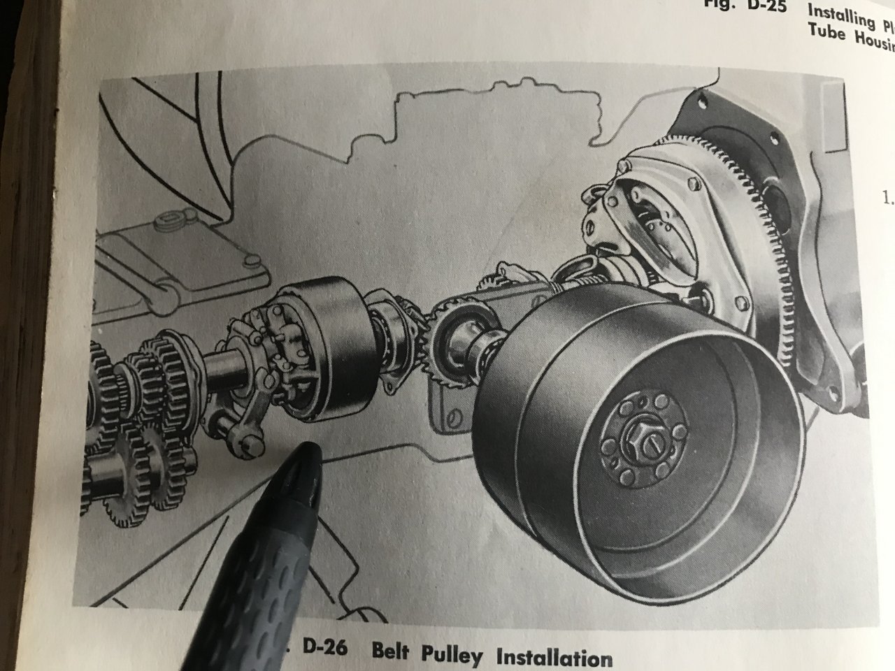

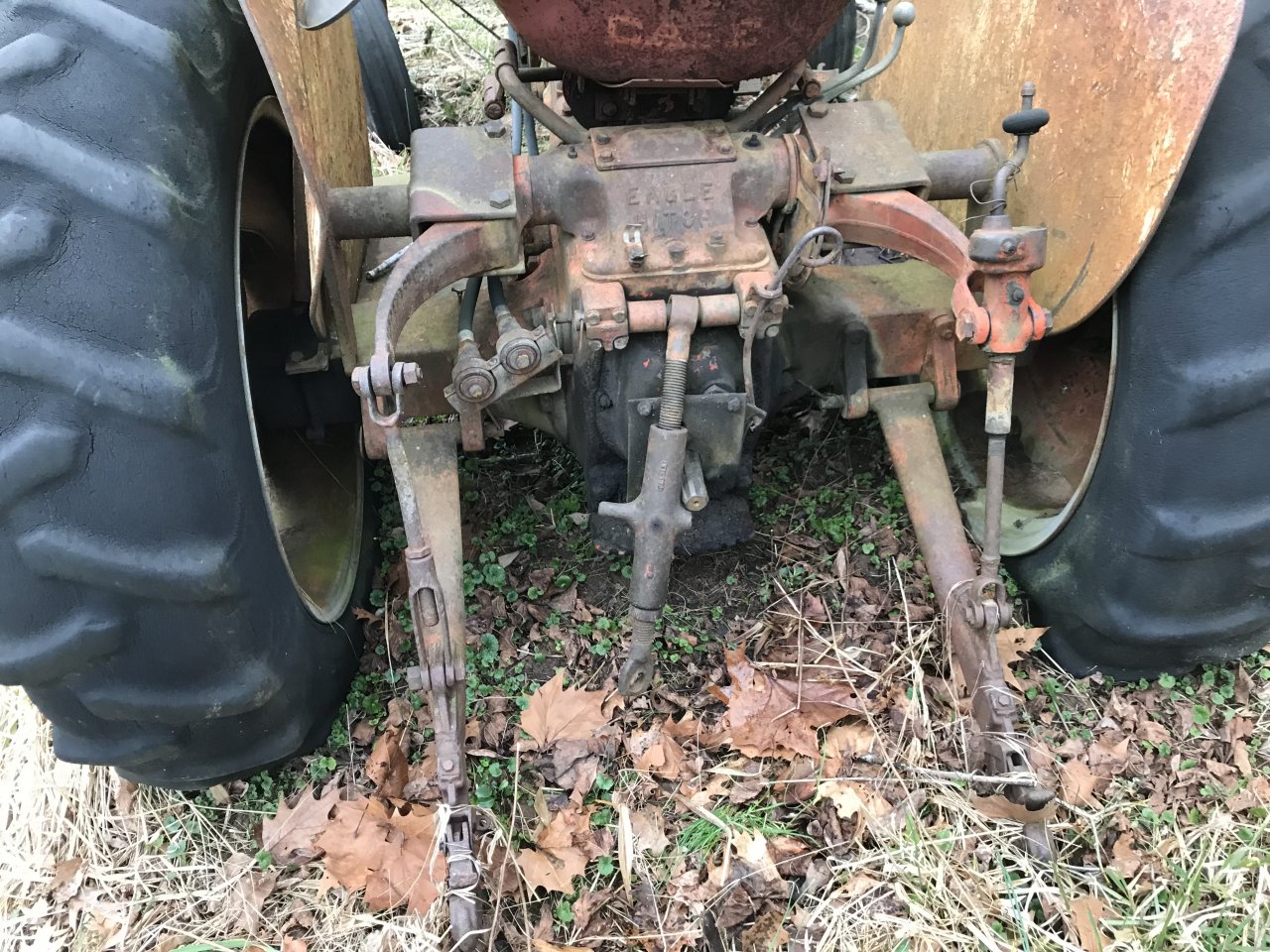

    D76B0457-06B1-4B45-A208-19CD4E001F40.jpeg 9CD9A3E7-06B0-4F50-94D6-9C48CE340D58.jpeg 3C240EAA-A05D-4899-808C-A52D1895F4D5.jpeg 93460F81-CDEE-4030-B0AC-5B1FB8889DB4.jpeg
    The “300” would be a series of tractor. Actually one of the 1st ( number series ) Case tractors was the 500 diesel in 1953. Everything before was letter series.... V, VA, SC, CC, DC, LA.
    The live PTO on the 300 comes from being able to stop the rear tires with the hand lever on the left of the torque tube, and the PTO continues to turn.
    The foot clutch operates both PTO and rear axle, but if you are brush hogging and want to switch gears, you simply move the hand lever on the left, which disengages the transmission but not the PTO. Hope that makes sense lol.....
    there are 3 levers in front of the seat... left is for snap clutch on transmission, center is 4 speed transmission, right side is 3 position range selector..... the taller lever in the pic on right is snap clutch. My tractor is same as the 311.....
